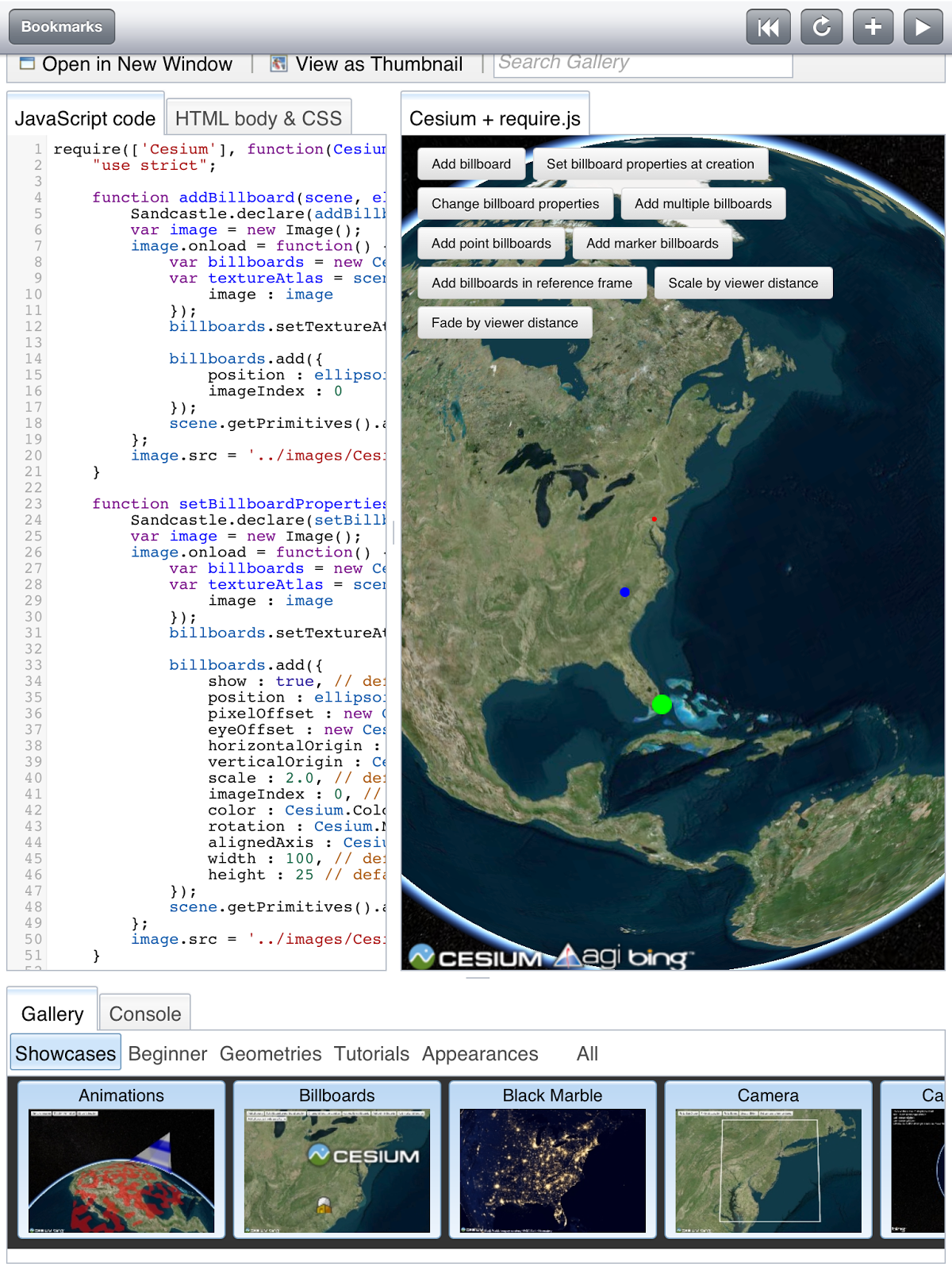

HI Kevin
I just ran successfully the sandcastle on my iPad. Here a screenshot from the iPad
This is not very quick but it works
Bruno

Hi Kevin
This is to b confirmed but in the very last OS X Marvericks, WebGL should be activated by default in Safari and Cesium will work as well
On the iPad, Cesium is not working in Safari. I found on the web, a project called “WEBGL Browser”. This is coming as a project to be compiled with Xcode and self deployed on your iPad. Then running Cesium that that non official Browser, you can be successful
Bruno
