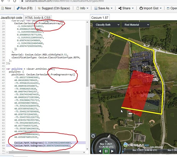

For example, here with the example here:
If a red rectangle is drawn on the card, with the help of “polygon and coordinates” but I do not understand how these coordinates came from or as I could remove the coordinates from a foreign map and integrate here in my cesium code. The red rectangle has 4 corners and when I look at the coordinates in the 1st polygon, there are a total of 8 coordinates. Since the coordinate points (Lat. and Lon) exist, I can still understand it. But in the 2nd polygon 22 are coordinates.
Similar to what Alexander said: It’s not clear for me whether the overarching question is about general interoperability between JavaScript and PHP, or interoperability between PHP and Cesium in particular. Different environments and different applications use different tech stacks and different languages, and combining two of them always bears challenges.
Don’t get me wrong: I agree that the learning curve is far too steep in modern web development, and it comes with a complexity that should better be hidden from those who only want to develop an end-user-facing application. That’s a general problem, and not one that Cesium alone can solve.
But Cesium has addressed this problem (IMHO better than many other companies) insofar that there is extensive documentation on the level of API documentation and tutorials, “Getting started” projects like the ones that Sam linked to, and support here in the forum. (At least, for questions that are specific to Cesium products - and to a lesser extent for the questions about how to combine JavaScript- and PHP-based tech stacks in general). And finally, the Sandcastle provides dozens of code snippets that allow you to interactively explore what is possible with CesiumJS.
Talking about the Sandcastle, and referring to your example:
As shown in the screenshot below, that other polygon (it is rather a polyline) shows the shape of a road, as a thick yellow line with a black outline:
You can also edit the coordinates in this array, hit “Run”, and observe the effect.

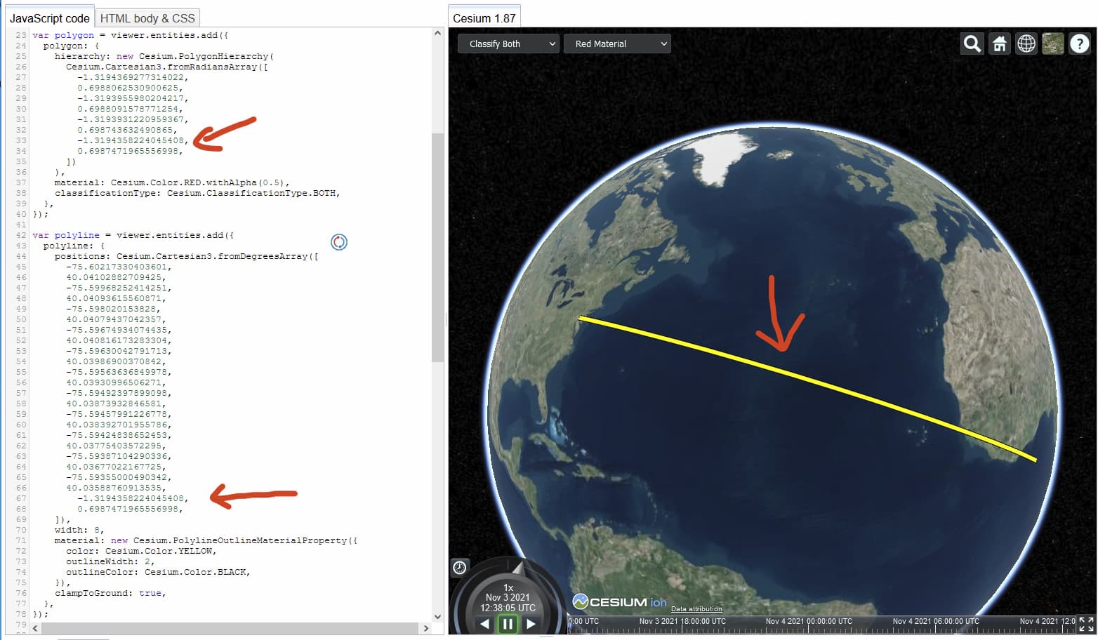

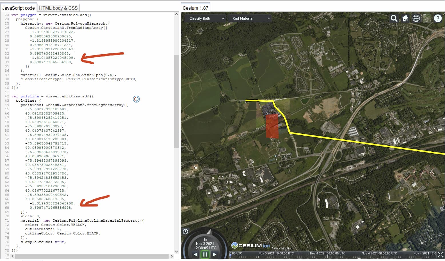

Ah okay, thanks for the hint. That this 2nd polygon refers to the street line I have only understood.
But in addition to the street line, a total of 2 rectangles are watching. One is in red and the other transparent. When the 1st polygon forms the red rectangle, where are the coordinates for the transparent rectangle?
How can I create the coordinates when I want to make a rectangle on the map (where other), as such as the red rectangle?
I copied the last 2 coordinates from the red rectangle (since I did not know where I can take the coordinates) and added at the end of the polyline. Since I thought, okay, it should lead the line to the red rectangle edge. I deceived. See the marked coordinates with the arrow and the street line in the screen.
The street line has landed somewhere in Africa. Is very funny?

Well… for the rectangle, the coordinates are given in radians, and the geometry is created using fromRadiansArray. For the street-polyline, the coordinates are given in degrees, and the geometry is created using fromDegreesArray .
If you want to let the line end at the corner of the rectangle, you could, for example, convert the radians to degrees, as shown in this image:

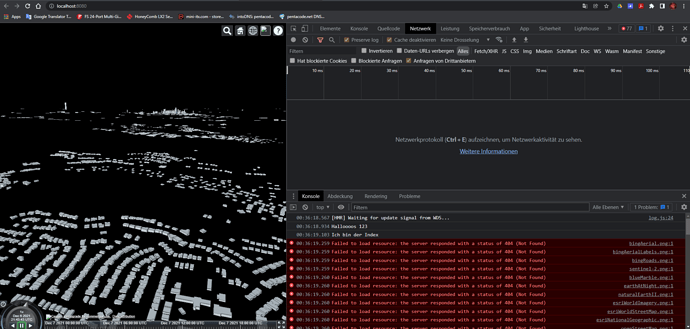

Hi,
something strange happened.
Although I use the repo from @sam.rothstein 1: 1, the map cannot load properly in the browser. The map is constantly zooming in and the icons are missing in the menu.
I tried to use an older version of Cesium. So from 1.88.0 to 1.84.0 I went down but the problem is always there.
Can someone tell me what happened here?
I also renewed my access token several times because I thought that I might be missing the access to something.
I ask for your urgent assistance.
Cannot use the card at all.

This is what all of the HTML looks like:
and so all the console bugs:

What I mean by that is: I have a fully functional config for Gulp and now also one with Webpack. But the problem with both is that if I integrate Cesium into the config file, Cesium no longer works.
CesiumJS may run a lot of projects and live websites. But as you say yourself, not all use Webpack etc. What I wanted to clarify with this is that in the 10 years there could be many more projects with Cesium if such current problems did not exist.
Change line 102 of webpack.config.js to
CESIUM_BASE_URL: JSON.stringify('js')
(See “Configuring CESIUM_BASE_URL” in the quickstart tutorial)
