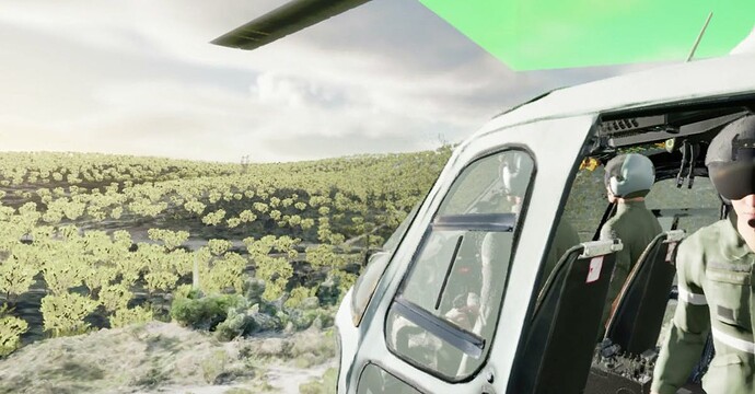

Cesium for Unreal has been used for a variety of flight simulators and adjacent applications! Here are some user stories from our website:
However, I will note that most of these applications use Cesium World Terrain with Bing Maps Aerial imagery, which have more manageable payloads for real-time flight visualization. Google’s Photorealistic 3D Tiles offer high visual fidelity (especially with all the available city photogrammetry), but naturally the higher detail will take longer to load.
So it really depends on your use case – and this ties into your fourth question. If you’re okay with having only terrain in your application (with no buildings), then Cesium World Terrain is the way to go. You can also combine it with Cesium OSM Buildings, which provide simplified representations of the buildings around the world. But if you want those photorealistic city views, you’ll want to use Google Photorealistic 3D Tiles.
