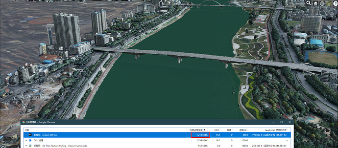

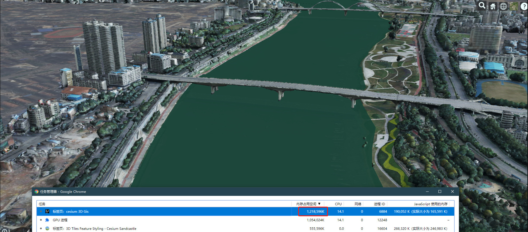

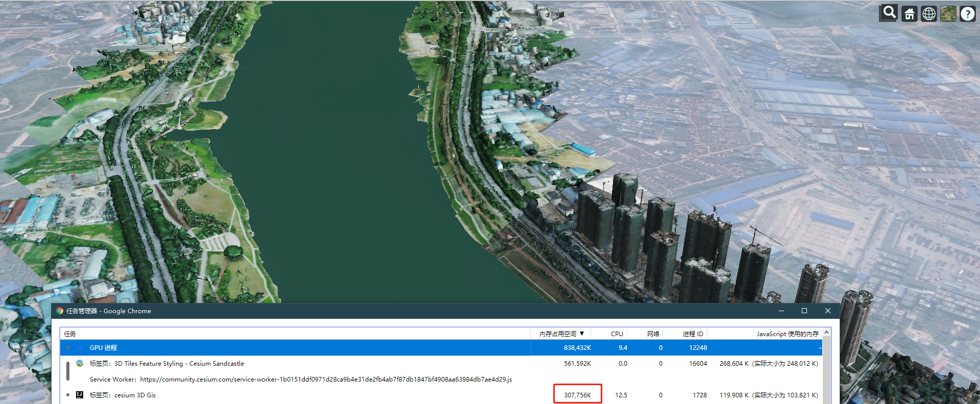

Roaming 3dtiles scene, memory has been increasing dramatically.
My 3dtiles file has 100G.
Ceisum version: 1.66

Created as:
var tileset = viewer.scene.primitives.add(new Cesium.Cesium3DTileset({
url: tiles[key].url,
clippingPlanes: clippingPlanes,
maximumScreenSpaceError: 16,
maximumMemoryUsage: 128,
dynamicScreenSpaceError: true,
immediatelyLoadDesiredLevelOfDetail: true,
How were these tiles created though? What software did you use to generate them? What type of data is the source model?
I converted through s3m-spec(https://github.com/SuperMap/s3m-spec/tree/master/ConvertTool),
The source file is s3m format
