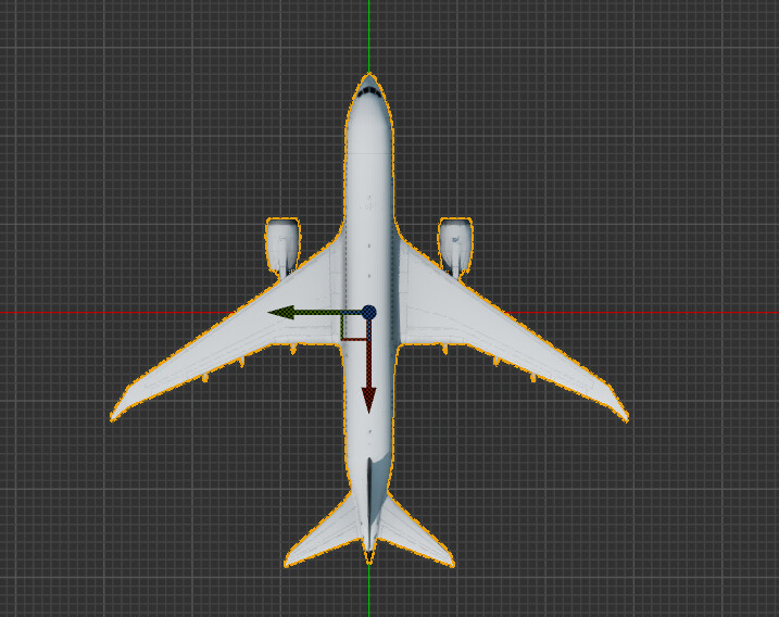

I have an aircraft with an axis like this:
Pitch and roll movements work fine here. However, when I place the blueprint in Cesium, I need to rotate the aircraft so it matches the direction of movement. However, when I do this the pitch and roll are switched (probably because of change of axis). So my question is: how can I rotate this axis 90 degrees independently of the aircraft mesh? With that, the rotation in Cesium and pitch and roll will work properly.

Hello. What I think happens is that the pitch and roll and done over the global axis, while they should be done over the local axis. How to change that is a mystery to me (I’m quite new to Unreal Engine).
When they would be performed over the local axis of the aircraft, then this issue should not occur. The problem is that the heading is used for yaw, which should be done using the global axis (the orientation by the Cesium world).
