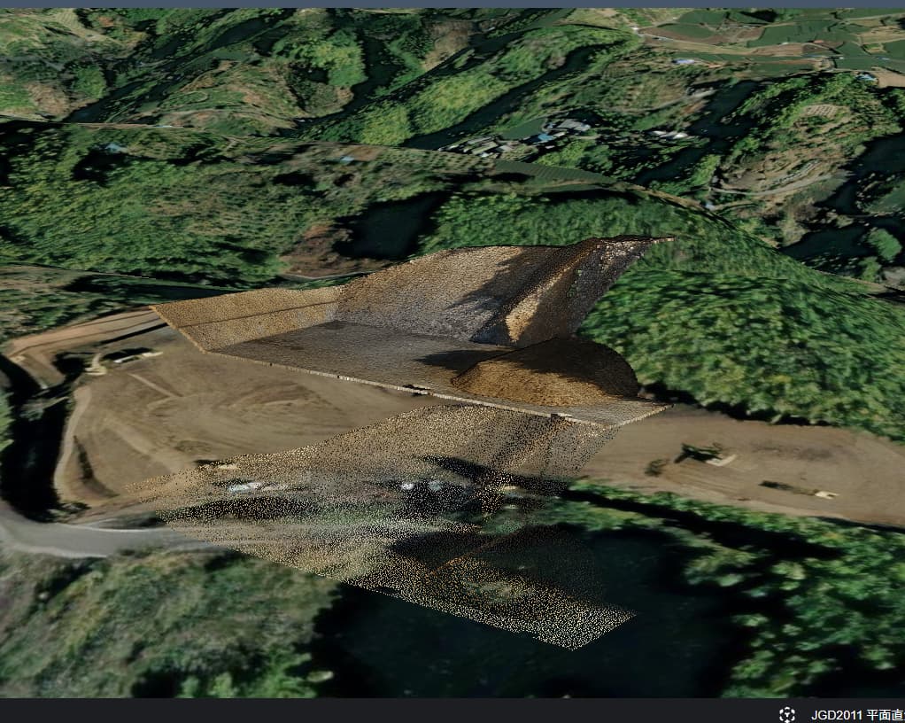

Hi there,
I tried to adjust the height of point cloud (MSL) to consider the vertical reference(WGS84) in Cesium.
However, I confront an weird afterimage like some tiles are not transferred along with the other tiles.

Hello there,
You correctly adjusted the height of the tiles, but that adjustment is happening multiple times each time a frame is rendered. When you pan or zoom the camera, I think the adjustment is being applied again.
I would suggest using the initialTilesLoaded event instead.

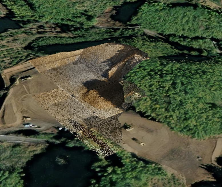

I tried it but it still the same…
I even tried this one but no change. I thought it would be rendering issue so I added this.viewer.render() but no change.

Is there a reason you are manually calling render? That’s typically not called by the user an is a internal function handled by Cesium when needed.
