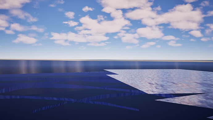

@Kevin_Ring I’m reopening this topic of tiles not loading during the render. I’ve read this full thread and I believe I’ve followed all of the directions here, but I’m unable to get the tiles to load in time for the render, unless I put extremely long warmup, like 4000 frames.
I’ve uploaded an example of a render with the tiles not loaded. You can see the sky and some water planes, but no Google Earth tiles.

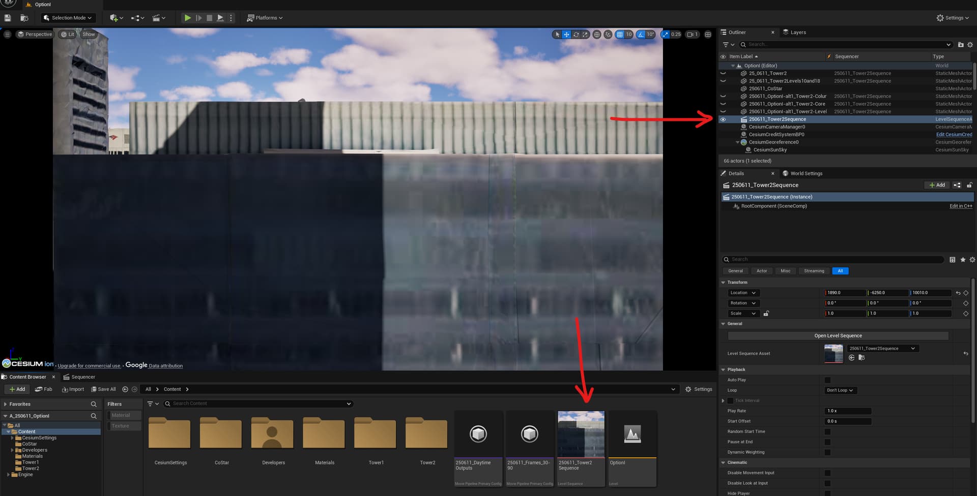

I’ve also uploaded a screenshot that shows that I think the level sequence is loaded into the level correctly.
What am I missing to force the renderer to wait for Cesium to load??
Hi @PCA_ejm,
I just tried recording a video of Google Photorealistic 3D Tiles using the Movie Render Queue, and it worked ok. The very first frame showed all of the tiles loaded.
It’s hard to guess why it’s not working in your case without more information. One possibility is that your movie is rendered from the perspective of some camera that is not the player controller’s camera. So Cesium doesn’t know to load (and wait for) tiles visible from the perspective of your movie’s camera. But in that case, I’m not sure how waiting 4000 frames would help.
So I guess I’d suggest starting with the Cesium for Unreal Samples project and see if you have the same problem there. If so, please share step-by-step instructions for what you did, so that we can do the same and see what’s going wrong.
If it does work in the Samples project, then presumably there’s something in your project that is breaking it. I can’t guess what that might be, but you might be able to narrow it down by removing things until it works.
