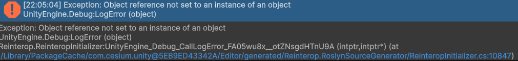

I’m trying to use this plugin in unity 6.0.60 and it works for a while but after some time the editor starts crashing alot.
These 2 errors keep popping up.
Any ideas how to solve this?

Unity just crashed on me and from my understanding its down to Cesium this time. At least the last entry to the stack is from Cesium.
I am on Unity 6.000.2.10f1 using Cesium For Unity 1.19. Also running some Unity XR related packages.
This popped up before the crash:
[./Library/PackageCache/com.cesium.unity@5EB9ED43342A/Runtime/generated/Reinterop.RoslynSourceGenerator/ReinteropInitializer.cs line 121906]
NullReferenceException: Object reference not set to an instance of an object
at UnityEngine.Bindings.Unmarshal.UnmarshalUnityObject[T] (System.IntPtr gcHandlePtr) [0x00031] in <3209c419f8514dc7af6f7bbce69cabc6>:0
at UnityEngine.GUIStyleState.get_background () [0x00015] in <63404e9af2c9442ab231fe73c8a5716f>:0
at UnityEditor.StyleSheets.StylePainter.DrawStyle (UnityEngine.GUIStyle gs, UnityEngine.Rect position, UnityEngine.GUIContent content, UnityEngine.DrawStates states) [0x00041] in <2fde32bfa1cb49eb86f50f1a654c74ac>:0
at (wrapper delegate-invoke) <Module>.invoke_bool_GUIStyle_Rect_GUIContent_DrawStates(UnityEngine.GUIStyle,UnityEngine.Rect,UnityEngine.GUIContent,UnityEngine.DrawStates)
at UnityEngine.GUIStyle.Draw (UnityEngine.Rect position, UnityEngine.GUIContent content, System.Int32 controlId, System.Boolean isHover, System.Boolean isActive, System.Boolean on, System.Boolean hasKeyboardFocus) [0x0004a] in <63404e9af2c9442ab231fe73c8a5716f>:0
at UnityEngine.GUIStyle.Draw (UnityEngine.Rect position, UnityEngine.GUIContent content, System.Int32 controlID, System.Boolean on, System.Boolean hover) [0x00017] in <63404e9af2c9442ab231fe73c8a5716f>:0
at UnityEngine.SliderHandler.OnRepaint () [0x000a7] in <63404e9af2c9442ab231fe73c8a5716f>:0
at UnityEngine.SliderHandler.Handle () [0x00064] in <63404e9af2c9442ab231fe73c8a5716f>:0
at UnityEngine.GUI.Slider (UnityEngine.Rect position, System.Single value, System.Single size, System.Single start, System.Single end, UnityEngine.GUIStyle slider, UnityEngine.GUIStyle thumb, System.Boolean horiz, System.Int32 id, UnityEngine.GUIStyle thumbExtent) [0x00036] in <63404e9af2c9442ab231fe73c8a5716f>:0
at UnityEngine.GUI.Scroller (UnityEngine.Rect position, System.Single value, System.Single size, System.Single leftValue, System.Single rightValue, UnityEngine.GUIStyle slider, UnityEngine.GUIStyle thumb, UnityEngine.GUIStyle leftButton, UnityEngine.GUIStyle rightButton, System.Boolean horiz) [0x0013a] in <63404e9af2c9442ab231fe73c8a5716f>:0
at UnityEditor.ZoomableArea.SliderGUI () [0x0019d] in <2fde32bfa1cb49eb86f50f1a654c74ac>:0
at UnityEditor.ZoomableArea.EndViewGUI () [0x0001d] in <2fde32bfa1cb49eb86f50f1a654c74ac>:0
at UnityEditor.GameView.OnGUI () [0x00588] in <2fde32bfa1cb49eb86f50f1a654c74ac>:0
at UnityEditor.HostView.InvokeOnGUI (UnityEngine.Rect onGUIPosition) [0x00078] in <2fde32bfa1cb49eb86f50f1a654c74ac>:0
at UnityEditor.DockArea.DrawView (UnityEngine.Rect dockAreaRect) [0x00001] in <2fde32bfa1cb49eb86f50f1a654c74ac>:0
at UnityEditor.DockArea.OldOnGUI () [0x001fc] in <2fde32bfa1cb49eb86f50f1a654c74ac>:0
at UnityEngine.UIElements.IMGUIContainer.DoOnGUI (UnityEngine.Event evt, UnityEngine.Matrix4x4 parentTransform, UnityEngine.Rect clippingRect, System.Boolean isComputingLayout, UnityEngine.Rect layoutSize, System.Action onGUIHandler, System.Boolean canAffectFocus) [0x002b9] in <9d8bee41f4d447c7bdc7f4c82643bb7e>:0
at UnityEngine.UIElements.IMGUIContainer.HandleIMGUIEvent (UnityEngine.Event e, UnityEngine.Matrix4x4 worldTransform, UnityEngine.Rect clippingRect, System.Action onGUIHandler, System.Boolean canAffectFocus) [0x000cc] in <9d8bee41f4d447c7bdc7f4c82643bb7e>:0
at UnityEngine.UIElements.IMGUIContainer.DoIMGUIRepaint () [0x00081] in <9d8bee41f4d447c7bdc7f4c82643bb7e>:0
at UnityEngine.UIElements.UIR.RenderChainCommand.ExecuteNonDrawMesh (UnityEngine.UIElements.UIR.DrawParams drawParams, System.Single pixelsPerPoint, System.Exception& immediateException) [0x000ec] in <9d8bee41f4d447c7bdc7f4c82643bb7e>:0
Rethrow as ImmediateModeException
at UnityEngine.UIElements.UIR.RenderTreeManager.RenderSingleTree (UnityEngine.UIElements.UIR.RenderTree renderTree, UnityEngine.RenderTexture nestedTreeRT, UnityEngine.RectInt nestedTreeViewport) [0x001c8] in <9d8bee41f4d447c7bdc7f4c82643bb7e>:0
at UnityEngine.UIElements.UIR.RenderTreeManager.RenderRootTree () [0x0006d] in <9d8bee41f4d447c7bdc7f4c82643bb7e>:0
at UnityEngine.UIElements.UIRRepaintUpdater.Render () [0x00024] in <9d8bee41f4d447c7bdc7f4c82643bb7e>:0
at UnityEngine.UIElements.BaseVisualElementPanel.Render () [0x00000] in <9d8bee41f4d447c7bdc7f4c82643bb7e>:0
at UnityEngine.UIElements.Panel.Render () [0x00014] in <9d8bee41f4d447c7bdc7f4c82643bb7e>:0
at UnityEngine.UIElements.UIElementsUtility.DoDispatch (UnityEngine.UIElements.BaseVisualElementPanel panel) [0x00063] in <9d8bee41f4d447c7bdc7f4c82643bb7e>:0
at UnityEngine.UIElements.UIElementsUtility.UnityEngine.UIElements.IUIElementsUtility.ProcessEvent (System.Int32 instanceID, System.IntPtr nativeEventPtr, System.Boolean& eventHandled) [0x0007f] in <9d8bee41f4d447c7bdc7f4c82643bb7e>:0
at UnityEngine.UIElements.UIEventRegistration.ProcessEvent (System.Int32 instanceID, System.IntPtr nativeEventPtr) [0x0001a] in <9d8bee41f4d447c7bdc7f4c82643bb7e>:0
at UnityEngine.UIElements.UIEventRegistration+<>c.<.cctor>b__1_2 (System.Int32 i, System.IntPtr ptr) [0x00001] in <9d8bee41f4d447c7bdc7f4c82643bb7e>:0
at UnityEngine.GUIUtility.ProcessEvent (System.Int32 instanceID, System.IntPtr nativeEventPtr, System.Boolean& result) [0x00083] in <63404e9af2c9442ab231fe73c8a5716f>:0
Crash!!!
