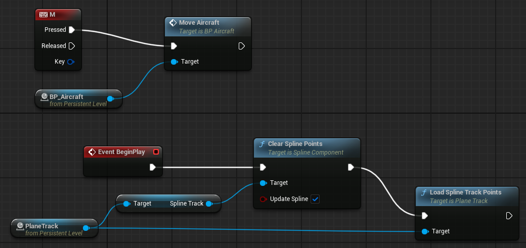

Level blueprint:

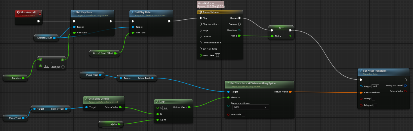

BP_Aircraft EventGraph:

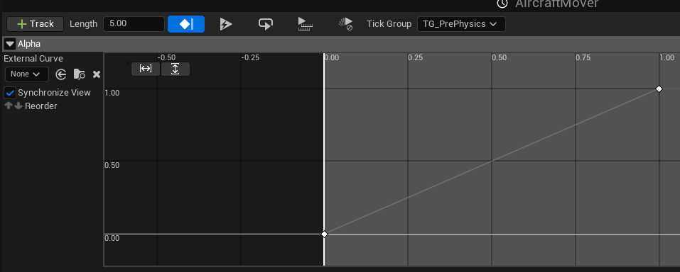

AircraftMover_Timeline:
I adjusted it to some extent and now when I press M I see the plane very short, before its gone. When I checked the arrival airport, the plane was there. Hence, it seems it moves too fast to its location.
Hi @FastFishy96,
I noticed that in your BP_Aircraft Event Graph, you’re dividing Duration by 1. It should actually be 1 divided by Duration. Let me know if that helps!
