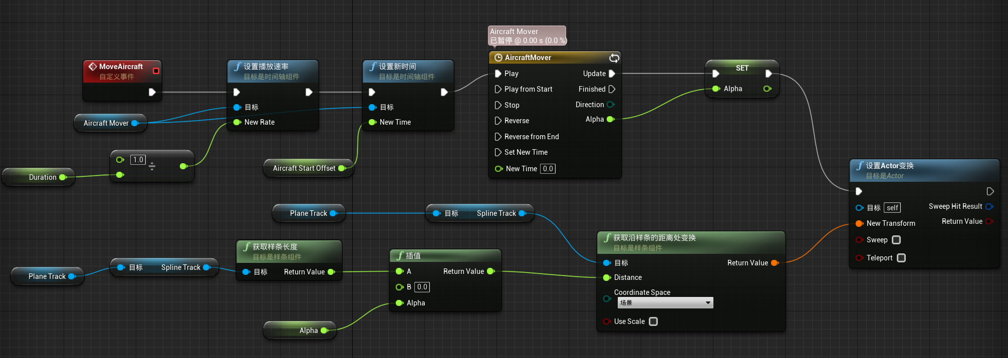

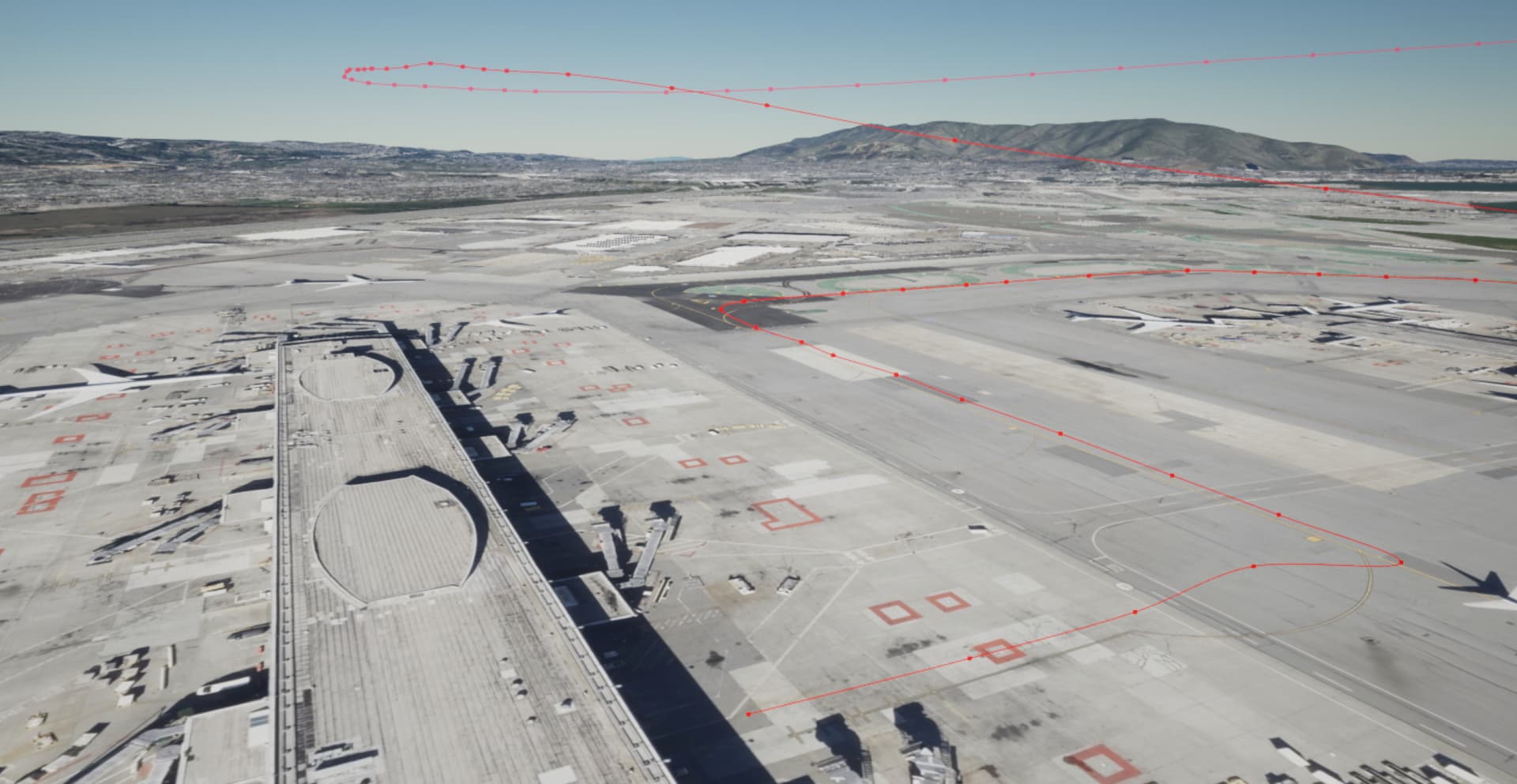

When I press M on the keyboard, my plane disappears。
Before starting:
After starting:

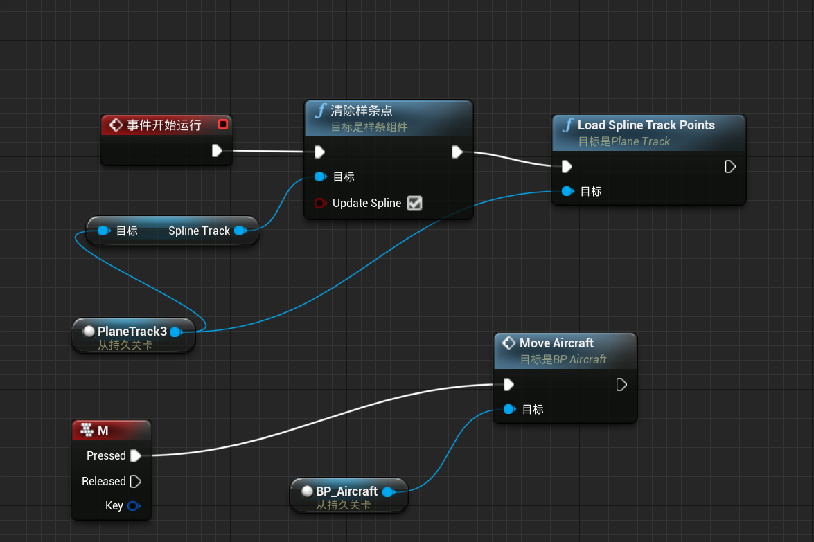

Hi @yonggandeliuguang,
I notice in your last blueprint image that you are using PlaneTrack3. Is it possible that you have multiple PlaneTracks in your scene?
-Alex
I only have a PlaneTrack and when I put a camera on top of the plane, I found that the plane can move. So I wonder if there’s a problem with coordinate conversion.
