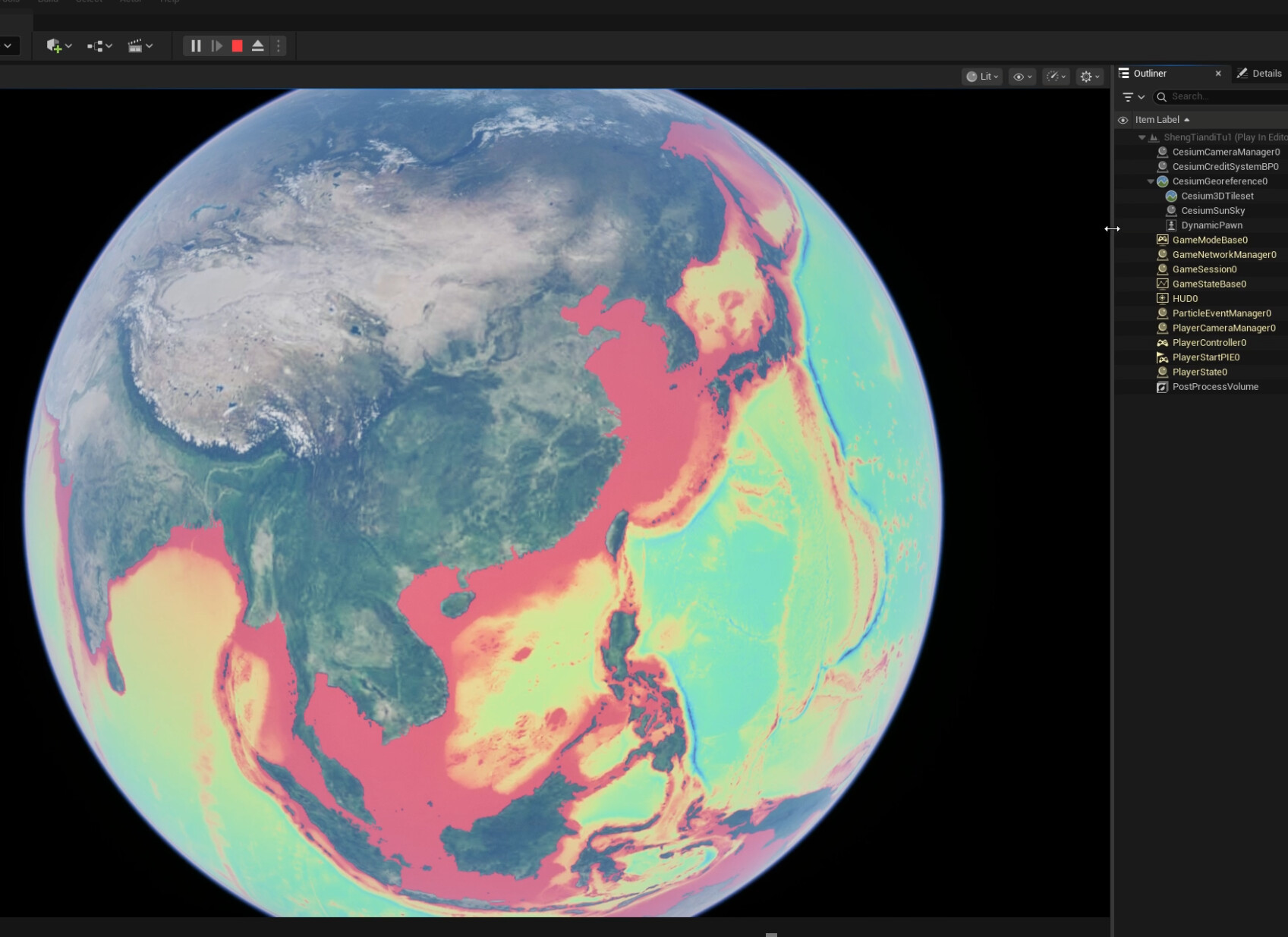

I put it into practice and the results are as follows.
The following image shows the ocean map in Mako style overlaying onto base map.
The following image shows the ocean map in Turbo style overlaying onto base map.

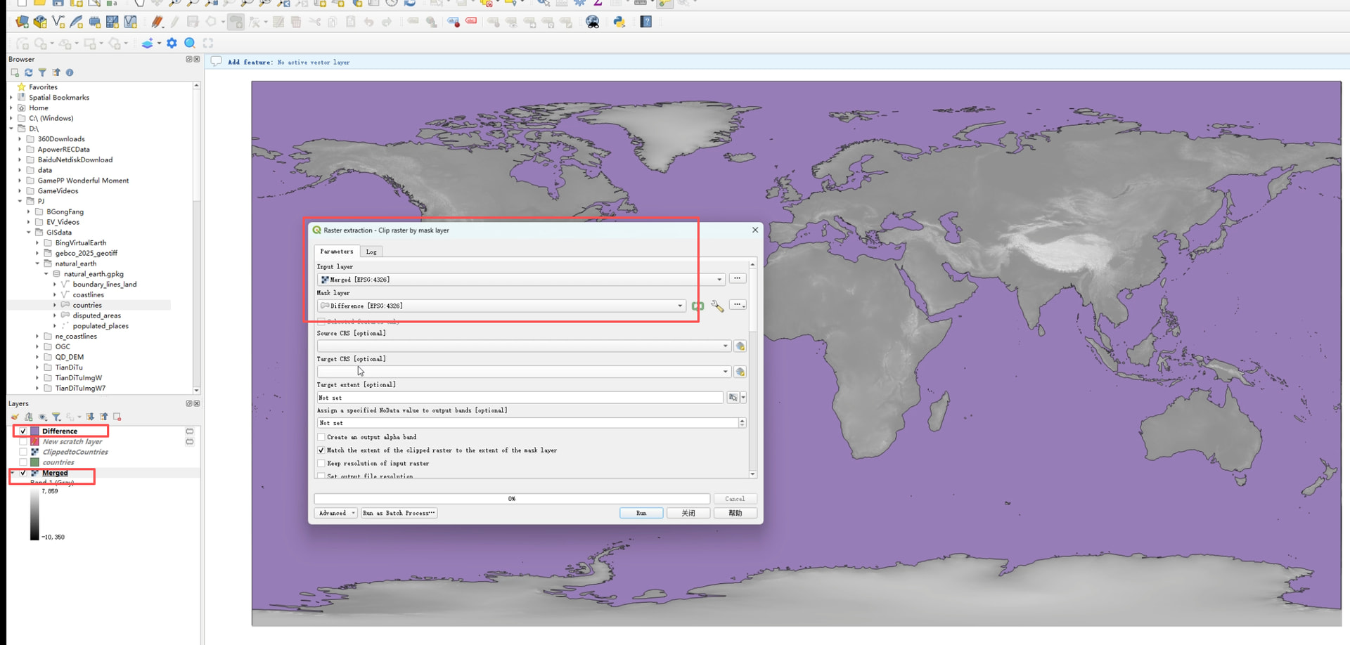

2. In QGIS, use the Mask Layer of world oceans to clip the GeoTiff Raster in step1.
(1) Merge the 8 tifs into one
(2)Clip the Merged Raster by the ocean mask layer

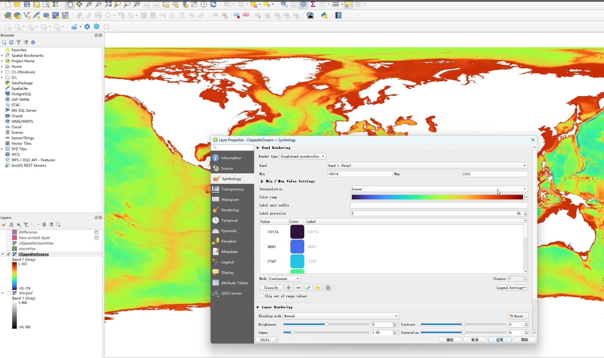

3.In QGIS, you can Symbolize the clipped raster in step2 with your favorite style.
4. Export this SLD Style and ClippedtoOceans GeoTiff from QGIS.

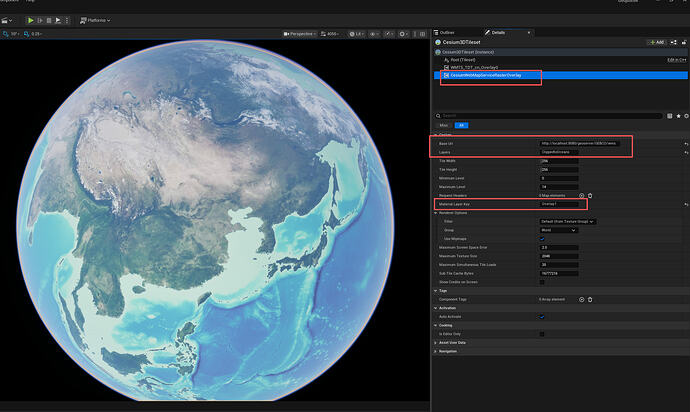

5. Publish the GeoTiff with the style in step4 as WMS in GeoServer.
6. In Cesium for Unreal, simply overlay the WMS layer of the Geoserver onto the base map
