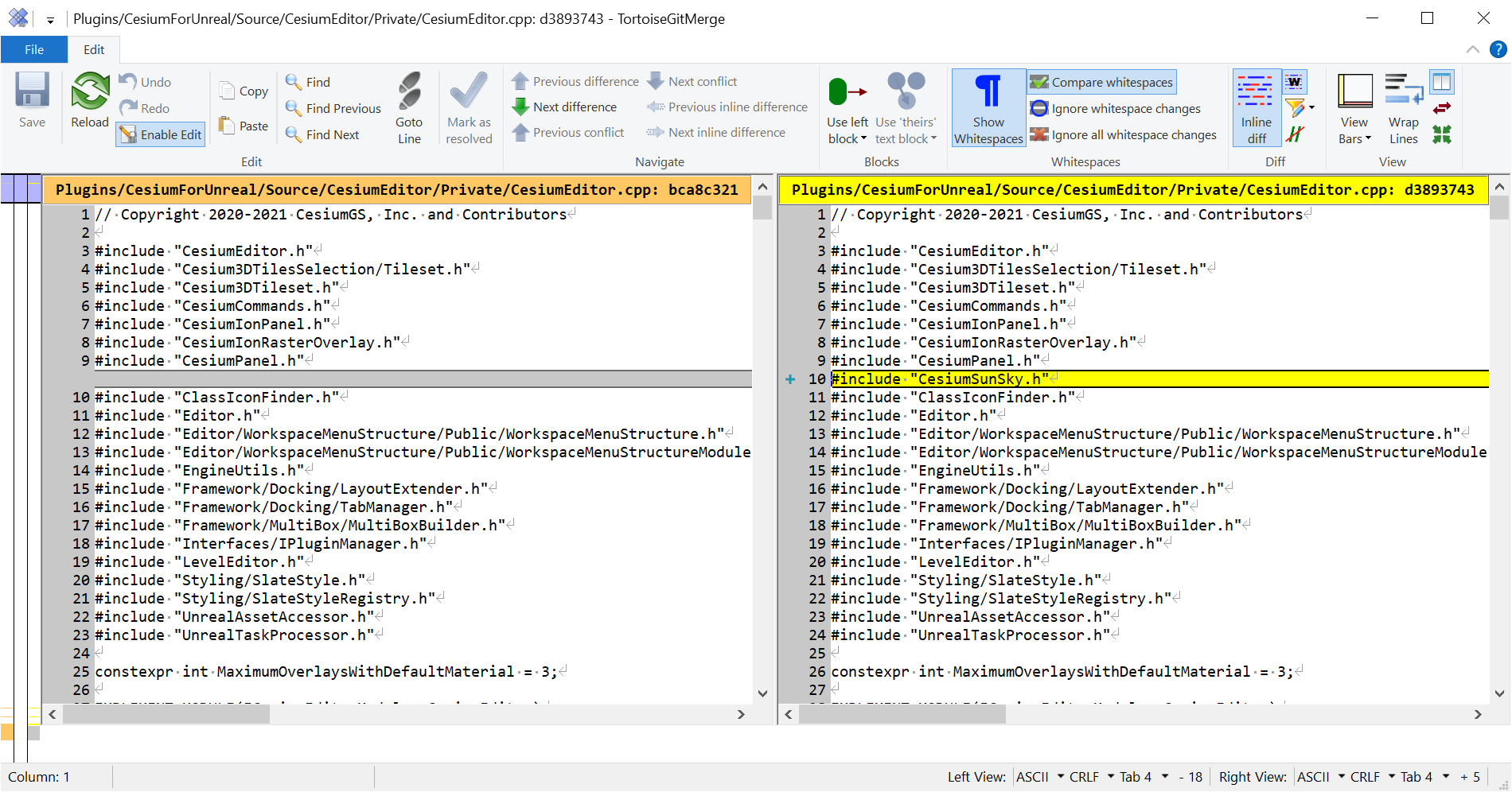

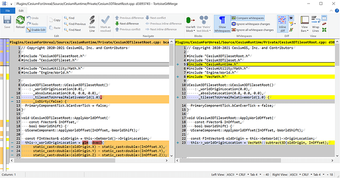

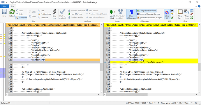

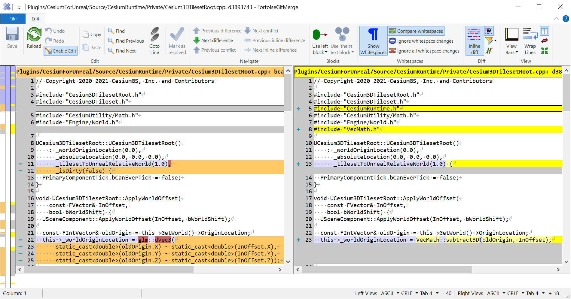

My edits are very small. They regard 1.7.0 package version of Github.
Only the header inclusions below:
and of course the most difficult to find: delete all “inline” from VecMath.cpp functions declarations
