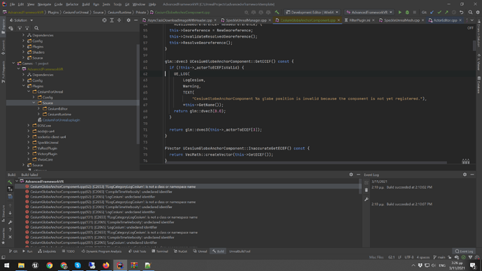

Build errors: migrating from Cesium 1.6.3 to 1.7.0 for ue4.26
Migrating from
v1.6.3
to v1.7.0 - 2021-11-01
resulted into various errors . Any idea ?
CesiumGlobeAnchorComponent.cpp(62): [C2653] ‘FLogCategoryLogCesium’: is not a class or namespace name
CesiumGlobeAnchorComponent.cpp(62): [C2065] ‘CompileTimeVerbosity’: undeclared identifier
CesiumGlobeAnchorComponent.cpp(62): [C2065] ‘LogCesium’: undeclared identifier
CesiumGlobeAnchorComponent.cpp(92): [C2653] ‘FLogCategoryLogCesium’: is not a class or namespace name
CesiumGlobeAnchorComponent.cpp(92): [C2065] ‘CompileTimeVerbosity’: undeclared identifier
CesiumGlobeAnchorComponent.cpp(92): [C2065] ‘LogCesium’: undeclared identifier
CesiumGlobeAnchorComponent.cpp(131): [C2653] ‘FLogCategoryLogCesium’: is not a class or namespace name
CesiumGlobeAnchorComponent.cpp(131): [C2065] ‘CompileTimeVerbosity’: undeclared identifier
CesiumGlobeAnchorComponent.cpp(131): [C2065] ‘LogCesium’: undeclared identifier
CesiumGlobeAnchorComponent.cpp(207): [C2653] ‘FLogCategoryLogCesium’: is not a class or namespace name
CesiumGlobeAnchorComponent.cpp(207): [C2065] ‘CompileTimeVerbosity’: undeclared identifier
CesiumGlobeAnchorComponent.cpp(207): [C2065] ‘LogCesium’: undeclared identifier
CesiumGlobeAnchorComponent.cpp(228): [C2653] ‘FLogCategoryLogCesium’: is not a class or namespace name
CesiumGlobeAnchorComponent.cpp(228): [C2065] ‘CompileTimeVerbosity’: undeclared identifier
CesiumGlobeAnchorComponent.cpp(228): [C2065] ‘LogCesium’: undeclared identifier
CesiumGlobeAnchorComponent.cpp(266): [C2664] ‘bool IsValid(const UObject *)’: cannot convert argument 1 from ‘const UWorld *’ to ‘const UObject *’
CesiumGlobeAnchorComponent.cpp(266): [C2664] Types pointed to are unrelated; conversion requires reinterpret_cast, C-style cast or function-style cast
Object.h(1543): [C2664] see declaration of ‘IsValid’
CesiumGlobeAnchorComponent.cpp(267): [C2653] ‘FLogCategoryLogCesium’: is not a class or namespace name
CesiumGlobeAnchorComponent.cpp(267): [C2065] ‘CompileTimeVerbosity’: undeclared identifier
CesiumGlobeAnchorComponent.cpp(267): [C2065] ‘LogCesium’: undeclared identifier
CesiumGlobeAnchorComponent.cpp(278): [C2027] use of undefined type ‘UWorld’
ActorComponent.h(25): [C2027] see declaration of ‘UWorld’
CesiumGlobeAnchorComponent.cpp(277): [C2737] ‘oldWorldOriginLocation’: const object must be initialized
CesiumGlobeAnchorComponent.cpp(345): [C2653] ‘FLogCategoryLogCesium’: is not a class or namespace name
CesiumGlobeAnchorComponent.cpp(345): [C2065] ‘CompileTimeVerbosity’: undeclared identifier
CesiumGlobeAnchorComponent.cpp(345): [C2065] ‘LogCesium’: undeclared identifier
CesiumGlobeAnchorComponent.cpp(382): [C2653] ‘FLogCategoryLogCesium’: is not a class or namespace name
CesiumGlobeAnchorComponent.cpp(382): [C2065] ‘CompileTimeVerbosity’: undeclared identifier
CesiumGlobeAnchorComponent.cpp(382): [C2065] ‘LogCesium’: undeclared identifier
CesiumGlobeAnchorComponent.cpp(405): [C2653] ‘FLogCategoryLogCesium’: is not a class or namespace name
CesiumGlobeAnchorComponent.cpp(405): [C2065] ‘CompileTimeVerbosity’: undeclared identifier
CesiumGlobeAnchorComponent.cpp(405): [C2065] ‘LogCesium’: undeclared identifier
CesiumGlobeAnchorComponent.cpp(471): [C2653] ‘FLogCategoryLogCesium’: is not a class or namespace name
CesiumGlobeAnchorComponent.cpp(471): [C2065] ‘CompileTimeVerbosity’: undeclared identifier
CesiumGlobeAnchorComponent.cpp(471): [C2065] ‘LogCesium’: undeclared identifier
CesiumGlobeAnchorComponent.cpp(483): [C2653] ‘FLogCategoryLogCesium’: is not a class or namespace name
CesiumGlobeAnchorComponent.cpp(483): [C2065] ‘CompileTimeVerbosity’: undeclared identifier
CesiumGlobeAnchorComponent.cpp(483): [C2065] ‘LogCesium’: undeclared identifier
CesiumGlobeAnchorComponent.cpp(494): [C2653] ‘FLogCategoryLogCesium’: is not a class or namespace name
CesiumGlobeAnchorComponent.cpp(494): [C2065] ‘CompileTimeVerbosity’: undeclared identifier
CesiumGlobeAnchorComponent.cpp(494): [C2065] ‘LogCesium’: undeclared identifier
CesiumGlobeAnchorComponent.cpp(535): [C2653] ‘FLogCategoryLogCesium’: is not a class or namespace name
CesiumGlobeAnchorComponent.cpp(535): [C2065] ‘CompileTimeVerbosity’: undeclared identifier
CesiumGlobeAnchorComponent.cpp(535): [C2065] ‘LogCesium’: undeclared identifier
CesiumGlobeAnchorComponent.cpp(545): [C2653] ‘FLogCategoryLogCesium’: is not a class or namespace name
CesiumGlobeAnchorComponent.cpp(545): [C2065] ‘CompileTimeVerbosity’: undeclared identifier
CesiumGlobeAnchorComponent.cpp(545): [C2065] ‘LogCesium’: undeclared identifier
CesiumGlobeAnchorComponent.cpp(555): [C2653] ‘FLogCategoryLogCesium’: is not a class or namespace name
CesiumGlobeAnchorComponent.cpp(555): [C2065] ‘CompileTimeVerbosity’: undeclared identifier
CesiumGlobeAnchorComponent.cpp(555): [C2065] ‘LogCesium’: undeclared identifier
CesiumGlobeAnchorComponent.cpp(687): [C2653] ‘FLogCategoryLogCesium’: is not a class or namespace name
CesiumGlobeAnchorComponent.cpp(687): [C2065] ‘CompileTimeVerbosity’: undeclared identifier
CesiumGlobeAnchorComponent.cpp(687): [C2065] ‘LogCesium’: undeclared identifier
CesiumGlobeAnchorComponent.cpp(712): [C2653] ‘FLogCategoryLogCesium’: is not a class or namespace name
CesiumGlobeAnchorComponent.cpp(712): [C2065] ‘CompileTimeVerbosity’: undeclared identifier
CesiumGlobeAnchorComponent.cpp(712): [C2065] ‘LogCesium’: undeclared identifier
Microsoft.MakeFile.targets(45, 5): [MSB3073] The command ““C:\Program Files\Epic Games\UE_4.26\Engine\Build\BatchFiles\Build.bat” AdvancedFrameworkVREditor Win64 Development -Project=“C:\UnrealProjects\advancedvrframeworktemplate\AdvancedFrameworkVR.uproject” -WaitMutex -FromMsBuild” exited with code 6.

  unresolved external symbol "public: static struct glm::vec<3,double,0> __cdecl VecMath::createVector3D(struct FVector const &)" (?createVector3D@VecMath@@SA?AU?$vec@$02N$0A@@glm@@AEBUFVector@@@Z) referenced in function "public: struct FVector __cdecl ACesiumGeoreference::InaccurateTransformEcefToUnreal(struct FVector const &)const " (?InaccurateTransformEcefToUnreal@ACesiumGeoreference@@QEBA?AUFVector@@AEBU2@@Z)
  unresolved external symbol "public: static struct glm::qua<double,0> __cdecl VecMath::createQuaternion(struct FQuat const &)" (?createQuaternion@VecMath@@SA?AU?$qua@N$0A@@glm@@AEBUFQuat@@@Z) referenced in function "public: struct FRotator __cdecl ACesiumGeoreference::InaccurateTransformRotatorEastNorthUpToUnreal(struct FRotator const &,struct FVector const &)const " (?InaccurateTransformRotatorEastNorthUpToUnreal@ACesiumGeoreference@@QEBA?AUFRotator@@AEBU2@AEBUFVector@@@Z)
  unresolved external symbol "public: static struct FMatrix __cdecl VecMath::createMatrix(struct glm::mat<3,3,double,0> const &)" (?createMatrix@VecMath@@SA?AUFMatrix@@AEBU?$mat@$02$02N$0A@@glm@@@Z) referenced in function "public: struct FMatrix __cdecl ACesiumGeoreference::InaccurateComputeEastNorthUpToEcef(struct FVector const &)const " (?InaccurateComputeEastNorthUpToEcef@ACesiumGeoreference@@QEBA?AUFMatrix@@AEBUFVector@@@Z)
  unresolved external symbol "public: static struct FRotator __cdecl VecMath::createRotator(struct glm::qua<double,0> const &)" (?createRotator@VecMath@@SA?AUFRotator@@AEBU?$qua@N$0A@@glm@@@Z) referenced in function "public: struct FRotator __cdecl ACesiumGeoreference::InaccurateTransformRotatorEastNorthUpToUnreal(struct FRotator const &,struct FVector const &)const " (?InaccurateTransformRotatorEastNorthUpToUnreal@ACesiumGeoreference@@QEBA?AUFRotator@@AEBU2@AEBUFVector@@@Z)
  unresolved external symbol "public: static struct glm::vec<4,double,0> __cdecl VecMath::add4D(struct FVector const &,struct FIntVector const &)" (?add4D@VecMath@@SA?AU?$vec@$03N$0A@@glm@@AEBUFVector@@AEBUFIntVector@@@Z) referenced in function "public: void __cdecl ACesiumGeoreference::PlaceGeoreferenceOriginHere(void)" (?PlaceGeoreferenceOriginHere@ACesiumGeoreference@@QEAAXXZ)
  unresolved external symbol "public: static struct glm::mat<4,4,double,0> __cdecl VecMath::createMatrix4D(struct FMatrix const &)" (?createMatrix4D@VecMath@@SA?AU?$mat@$03$03N$0A@@glm@@AEBUFMatrix@@@Z) referenced in function "private: struct glm::mat<4,4,double,0> const & __cdecl UCesiumGlobeAnchorComponent::_updateGlobeTransformFromActorTransform(void)" (?_updateGlobeTransformFromActorTransform@UCesiumGlobeAnchorComponent@@AEAAAEBU?$mat@$03$03N$0A@@glm@@XZ)
  unresolved external symbol "public: static struct FMatrix __cdecl VecMath::createMatrix(struct glm::mat<4,4,double,0> const &)" (?createMatrix@VecMath@@SA?AUFMatrix@@AEBU?$mat@$03$03N$0A@@glm@@@Z) referenced in function "private: struct FTransform __cdecl UCesiumGlobeAnchorComponent::_updateActorTransformFromGlobeTransform(class std::optional<struct glm::vec<3,double,0> > const &)" (?_updateActorTransformFromGlobeTransform@UCesiumGlobeAnchorComponent@@AEAA?AUFTransform@@AEBV?$optional@U?$vec@$02N$0A@@glm@@@std@@@Z)
  unresolved external symbol "public: static struct FQuat __cdecl VecMath::createQuaternion(struct glm::qua<double,0> const &)" (?createQuaternion@VecMath@@SA?AUFQuat@@AEBU?$qua@N$0A@@glm@@@Z) referenced in function "private: void __cdecl UCesiumGlobeAnchorComponent::_onActorTransformChanged(class USceneComponent *,enum EUpdateTransformFlags,enum ETeleportType)" (?_onActorTransformChanged@UCesiumGlobeAnchorComponent@@AEAAXPEAVUSceneComponent@@W4EUpdateTransformFlags@@W4ETeleportType@@@Z)
  14 unresolved externals
  Microsoft.MakeFile.targets(45, 5): [MSB3073] The command ""C:\Program Files\Epic Games\UE_4.26\Engine\Build\BatchFiles\Build.bat" AdvancedFrameworkVREditor Win64 Development -Project="C:\UnrealProjects\advancedvrframeworktemplate\AdvancedFrameworkVR.uproject" -WaitMutex -FromMsBuild" exited with code 6.
Those symbols are all in VecMath.cpp. I can’t think of why they would be unresolved as long as that file is in the project as well.
In 1.6.3 you call CesiumRuntime.h in the following files
in 1.7.0 I have it
So the comparison may give the solution
I have added in the header files of TilesetRoot and GlobeActorComponent
DECLARE_LOG_CATEGORY_EXTERN(LogCesium2, Log, All);
DECLARE_LOG_CATEGORY_EXTERN(LogCesium3, Log, All);
and changed the ULog tags and the related errors dissappear.
But the glm errors appear. So I guess adding CesiumRuntime.h in the header is right. It is just a precompile error. So indeed the glm libraries are missing. The glms with the Ulogs are irrelevant errors. It is just progressing in the compile.
I don’t think including CesiumRuntime.h is causing those errors. Rather, it’s fixing all the compiler errors so that you actually get to the linking step, at which point you see those VecMath unresolved symbol linker errors.
I can not find the necessary library for
glm:mat4<4,4,double,0>
I have tried
#include <glm/mat4x4.hpp>
#include <glm/ext/matrix_double4x4.hpp>
#include <glm/ext/matrix_double4x4_precision.hpp>
Right, you’re not missing anything GLM related, though. You’re missing the implementation of VecMath functions, which happen to return GLM types. Scroll a bit more to the right in the error message. The implementations are in VecMath.cpp, you just need to figure out why it’s not finding them.
