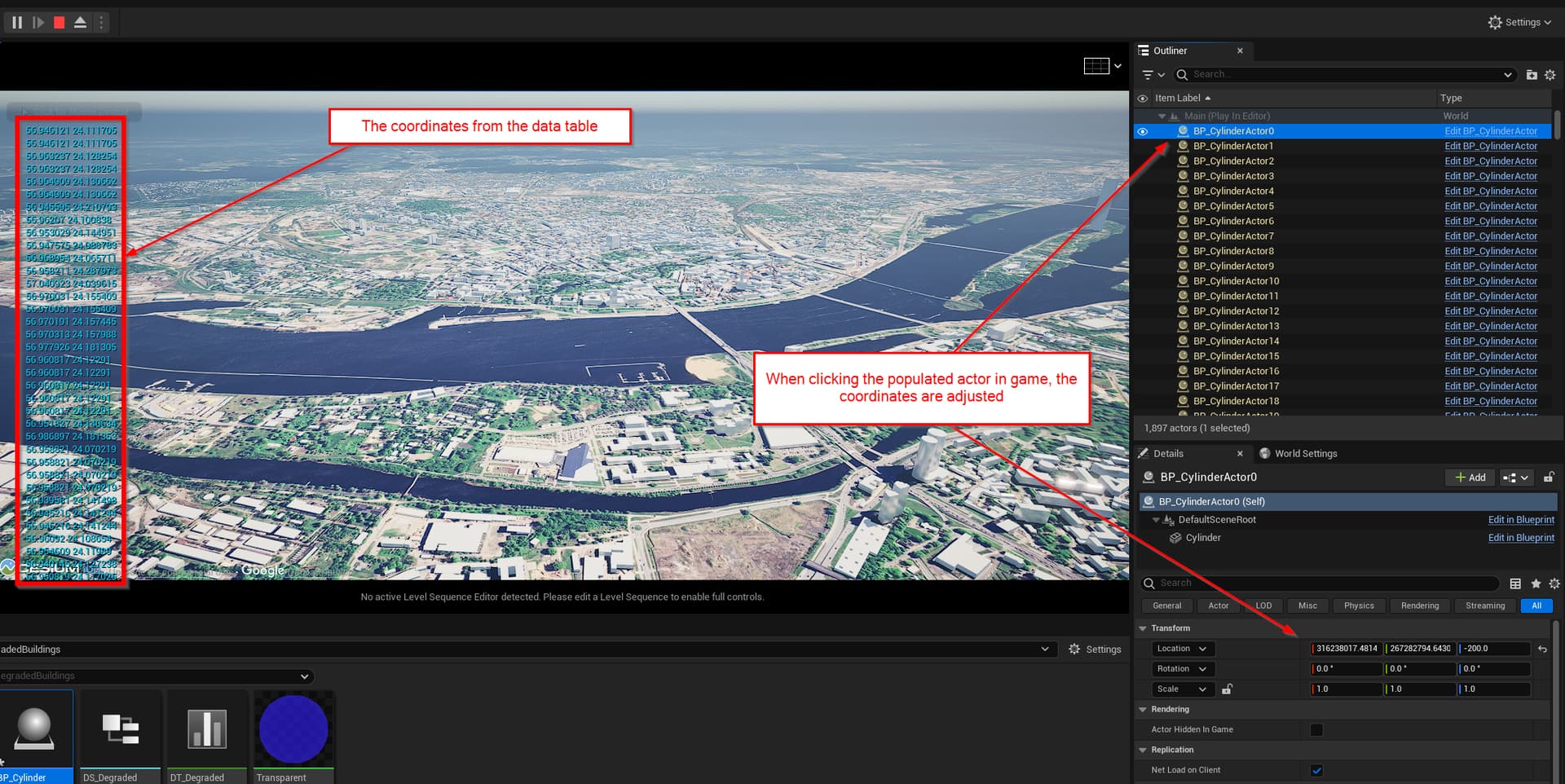

I am using Cesium for Unreal for the creation of a city Digital Twin. I have obtained some building locations which I have imported in Unreal Engine as a data table and used an actor to spawn cylinders as placeholder items to view the locations of those coordinates. I have set up my Cesium within Unreal correctly and overlayed OSM Buildings as well.
However, when I run the game, those placeholder cylinders are shown as positioned in the environment
But not shown on my runtime viewport
This image should have some cylinders with a transparent materials applied.
Please advise.
Further to my previous post, I managed to load the cylinders. However, all cylinders are placed within the same location instead of scattered around… I believe it has to do with multiplying and how Cesium treats units within Unreal Engine.

Further trials resulted in the following
However, it still does not populate. I can see that it reads the coordinates from the data table, it converts them to something different but still it does not appear…
As before, any advise is appreciated.

There is a post pending with a newly created image, however please see my newly created Blueprint that scatters the cylinders in the correct area, however not in the corrector positions (some of the cylinders end up in a river where these should distinguish buildings). Upon approval the screenshot will show progress
Hi Kevin, thank you for this observation! Trully indeed, the lat, long needed to be vice versa, plus I moved the -200 of Z to 0.
I am starting getting some results. See screenshot below:
What it looks odd is, that although the cylinders are now scattered, still they do not fall into the correct place. These cylinders demonstrate the position of degraded buildings, but some end up in the river. I double-checked the coordinates and they are correct in Google Maps.
Any further advise is always welcome!
You’ve flipped the X and Y coordinates passed to the SpawnActor node. Those are Cartesian Unreal world coordinates, not longitude/latitude.
Thank you Kevin for this information! Can you please elaborate a bit more? Shouldn’t I flip those? How to go from Cartasian to WGS via Cesium? I am a bit puzzled here…
And success! Thank you Kevin, I flipped back the X and Y coordinates and it finally works! Thank you for your support!
