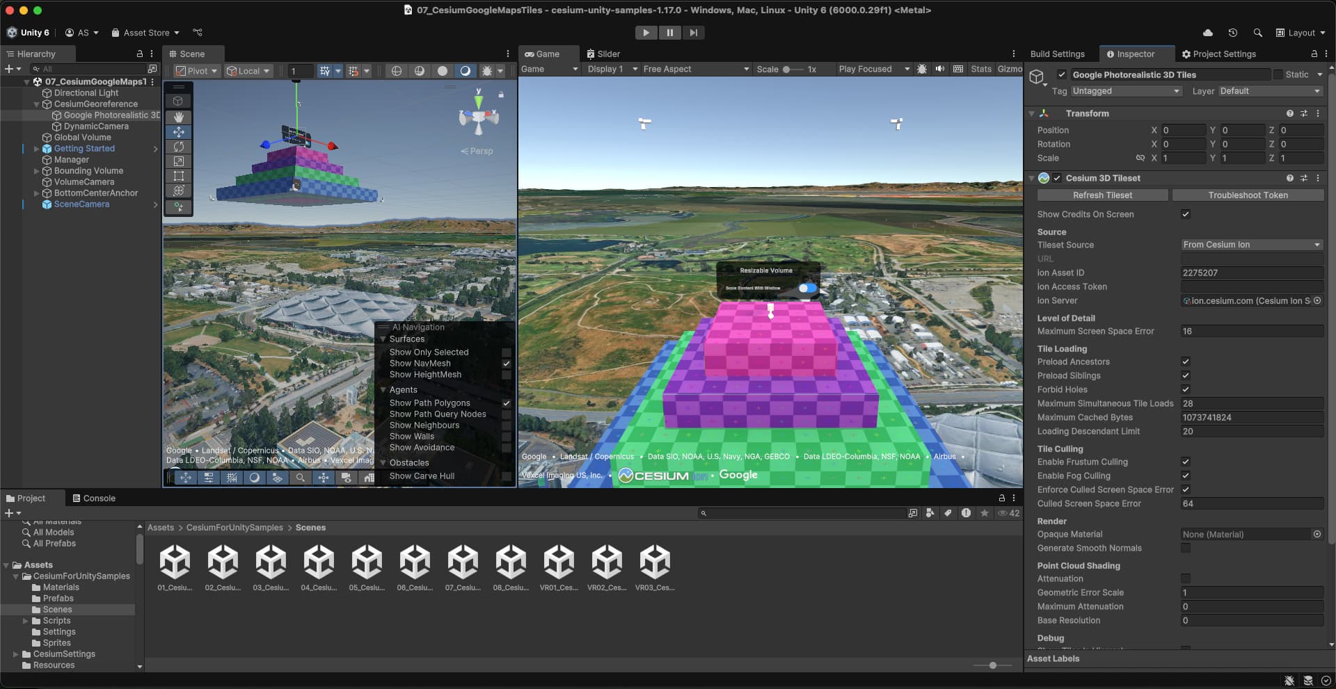

Interesting. Is this to the point that it works on the Apple Vision Pro? I downloaded 1.17 to try it on the AVP, but can’t find a good way to balance the Scene and Volume Cameras of Polyspatial with the Global Volume and CesiumGeoreference systems of Cesium.
