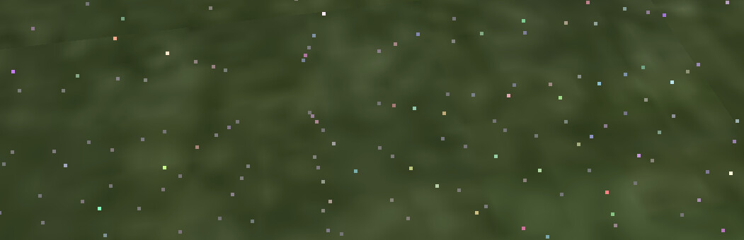

이미지를 첨부할게
Good day @namjihyeon, thank you so much for your sample code. I successfully implemented it on my local machine, and below is a sample GIF of my implementation.
chrome-capture-2024-0-23
