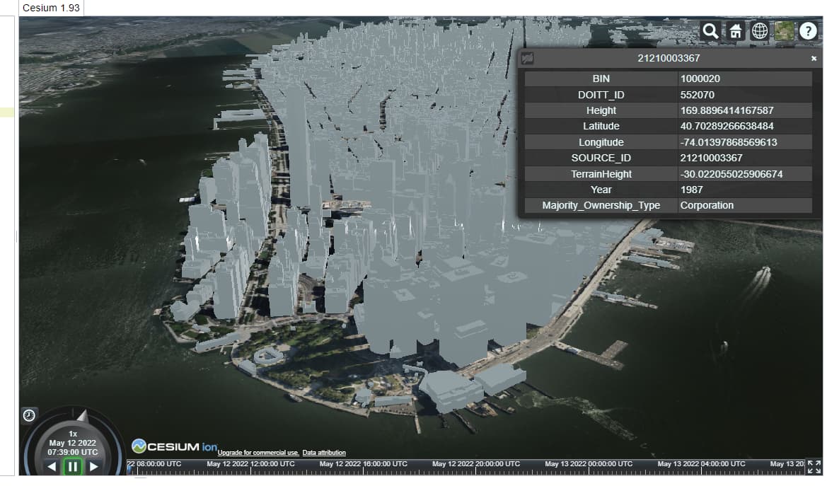

hi,
here is a very basic sandcastle, if i pick a building I get the info box - how can I disable that ?

HI @Ruediger_Brand,
if you want to disable the Infobox for specific tilesets, but enable it for other tilesets, you can create your own ScreenSpaceEventHandler (listening to left mouse click e.g.) und use the tilesets url in an if-else-statement:
// Create and define own ScreenSpaceEventHandler
let selectionhandler = new Cesium.ScreenSpaceEventHandler(viewer.scene.canvas);
selectionhandler.setInputAction(function onLeftClick (movement) {
// pick a feature
const pickedFeature = viewer.scene.pick(movement.position);
// specify your if-else-condition
const condition = 'URL OF SPECIFIC TILESET'
if (pickedFeature.tileset._url === condition) {
viewer.selectedEntity = null;
}, Cesium.ScreenSpaceEventType.LEFT_CLICK);
If you want to disable ht Infobox for the whole App use the solution Alexander posted.
Best, Lennart
EDIT: if you want to get the url of some ionAssets you can use following code
const url = await Cesium.IonResource.fromAssetId('IonID').then(
function (response){
return response._url
or just use https://assets.cesium.com/{ION_ID}/tileset.json

Hi,
this works - maybe it could be an improvement, to set a flag at the Tileset-constructor options, like the enablePickFeatures in the Cesium.ArcGisMapServerImageryProvider.
I don’t know your implementation, but I think with this screenspacehandler InputAction I overwrite a default behaviour of the tileset - so something similar must exist, which now is out of order.
