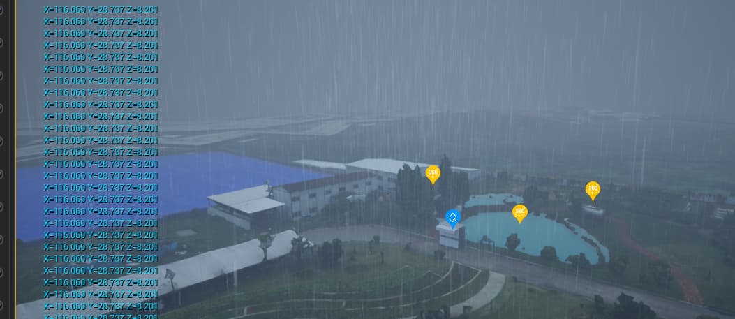

Thank you for your reply. Now I will tell you what the situation is according to what I know. I don’t know how to use the two functions you told me, please forgive me.Now what I know is that when I’m using it in the editor if my camera’s perspective changes the position of the print changes but the position of the object doesn’t change and it’s only when I pack it and my camera moves that the water moves.Now I’m going to show you some screenshots of me in action
The packaged health state
It is worth mentioning that when I run it from the packed state, the location of each body of water is mostly around that location and I believe it has been converted by some plugins
Above is the simulated state of the editor
Next is the packaged state
Forgive me if it’s a little messy

Hello, I still have a question. When I prohibit the camera and camera from approaching the near camera, the position of the water body will not change. The position of the water body is still not correct
The coordinate transformation didn’t seem to work

Thanks for testing this out. I’m pretty certain at this point that it’s a bug with the water plugin, and I don’t know that there’s anything you can do on your end to resolve it. Like you found, the transform position of the water isn’t actually changing at all, but it visually moves and renders in an incorrect spot. I’ve also found that the water likes to follow you if you move the camera away from the scene.
I’m not sure if this is caused because of the georeferencing in the Cesium plugin, or some other issue. I’ve made an issue on our github repository to take note of it for the future - Water plugin custom water bodies render in an incorrect location with Cesium for Unreal · Issue #609 · CesiumGS/cesium-unreal · GitHub
