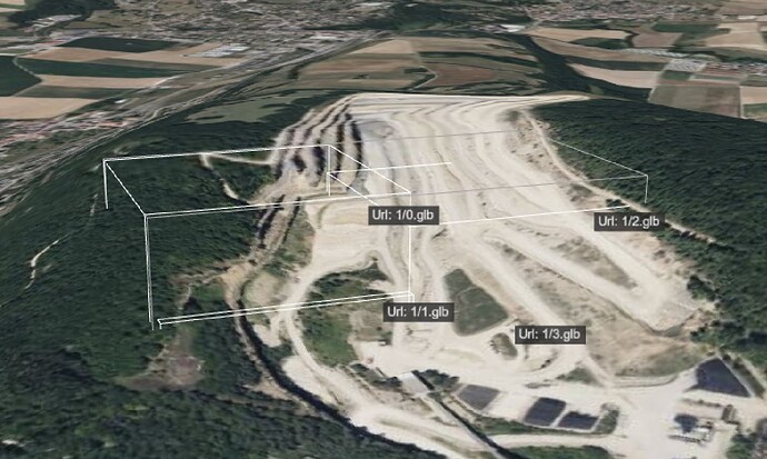

It likes here:
ply
format binary_little_endian 1.0
comment SRS=ENU:46.65466,6.53857
element vertex 500967
property float x
property float y
property float z
property float f_dc_0
property float f_dc_1
property float f_dc_2
property float f_rest_0
property float f_rest_1
property float f_rest_2
property float f_rest_3
property float f_rest_4
property float f_rest_5
property float f_rest_6
property float f_rest_7
property float f_rest_8
Thank you. Mine doesn’t seem to be georeferenced. Perhaps that’s why.
