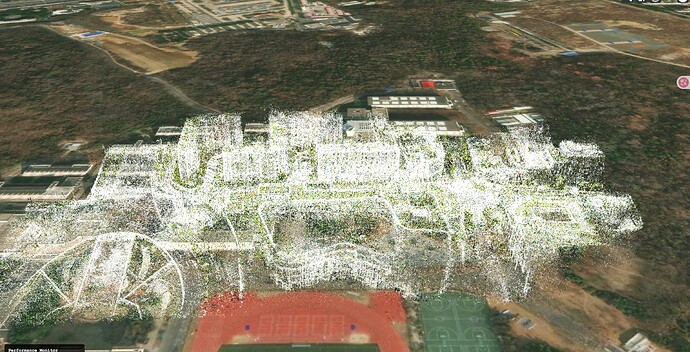

I have been searching up online about some of the available tools to convert 3DGS files to 3D Tiles, but there’s not many. I wonder if anyone has any good recommendations, especially for converting large scenes?
I did try one tool called GISBox, but the results turned out to be very sparse and performance was very low for large scenes(~10m splats). Not sure if it’s the tool’s problem or CesiumJS has a limit on the rendering. Would appreciate any help on it!
There is a lot of research and development going on around Gaussian splatting right now. Support for Gaussian splats in CesiumJS via the KHR_spz_gaussian_splats_compression extension has only been added recently, and the extension is not even finalized. Similarly, producers are developing tooling to convert between different splat formats, and to eventually generate it in a form that is suitable for 3D Tiles.
But note that as part of the recent development efforts by Cesium, Cesium ion now supports uploading Gaussian splat data as .PLY files, and converting them into 3D Tiles 1.1. tilesets. You might want to give that a try.
(An aside: The screenshot looks like it is rather a (somewhat sparse) point cloud. Which data was this created from, and does this data actually represent Gaussian splats?)

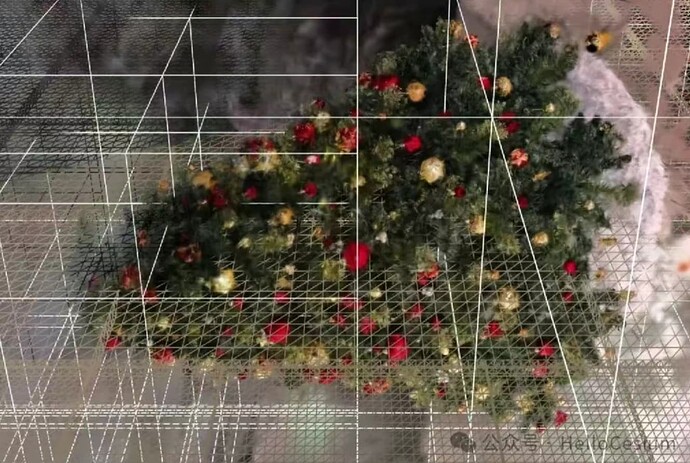

Now supports octree LOD :melting_face:
That sounds cool! How large of a splat file can you handle now and how about the performance and quality? I have also been looking into a tool called splat-3dtiles and it looks quite promising to me now.
I tested a ply data. The original data is ChristmasTree.ply (419M), and the corresponding ChristmasTree.splat is 55M. The number of points is not large, point number 1,774,942.
  1. Without LOD, the resulting data is 22.4M.
  2. With LOD octree partitioning, the resulting data is 27.3M.
