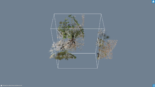

Hello,
My 3dgs data is
(home view)
(left side view)
The tree rotates sideways.
2025年7月15日(火) 23:35 Ankit Trehan via Cesium Community <notifications@cesium.discoursemail.com>:
Hi,
Thank you for providing me with this information. I have opened an issue with the tilers team for them to take a look at. I apologize for not asking this earlier but could you please also share the asset id for the above asset.
