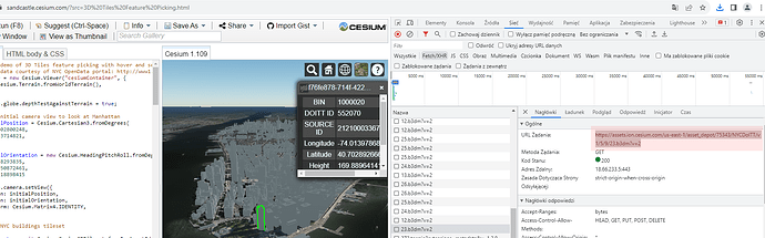

How can i see attributes of OSM data?
Cesium for Unreal can show metadata of OSM,however,when do select by keys, i have no idea about key value, and OSM data come from cesium ion.
Another, Can CesiumEncodedMetadata modify metadata?
I’m not quite sure where you’re running into trouble. You say “Cesium for Unreal can show metadata of OSM.” What are you trying to do beyond that? Or you believe it’s possible, but you don’t know how to do it? If that’s the case, check out the Metadata level in the Cesium for Unreal Samples project:
It’s not currently possible to modify the metadata. If you want to modify the metadata for Cesium OSM Buildings specifically, I suggest you make contributions to OpenStreetMap.

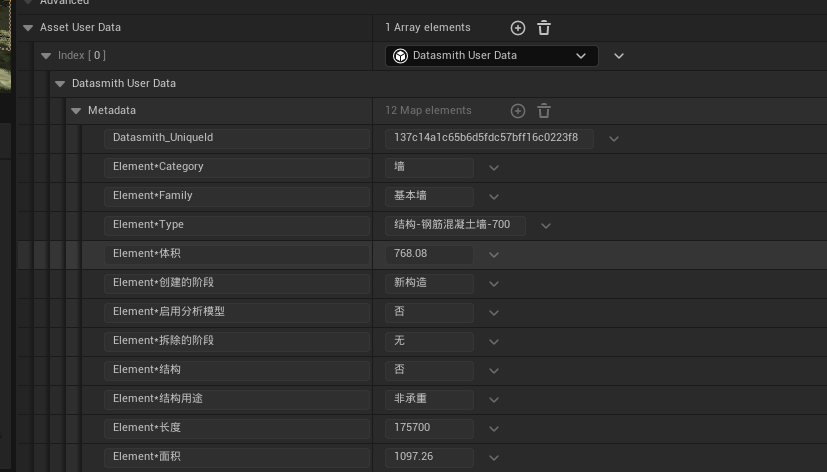

Maybe i want to add 3d data with metadata or attribute, then show the table of info, it is like OSM metadata Sample project. I have not find a suitable way based on Cesium for Unreal.
And, i know Datasmith supported by UE5 can import BIM model, and the same time, i can use it’s metadata by self, however, i dont want use datasmith data.
So, i want to find a new way to do the same thing.

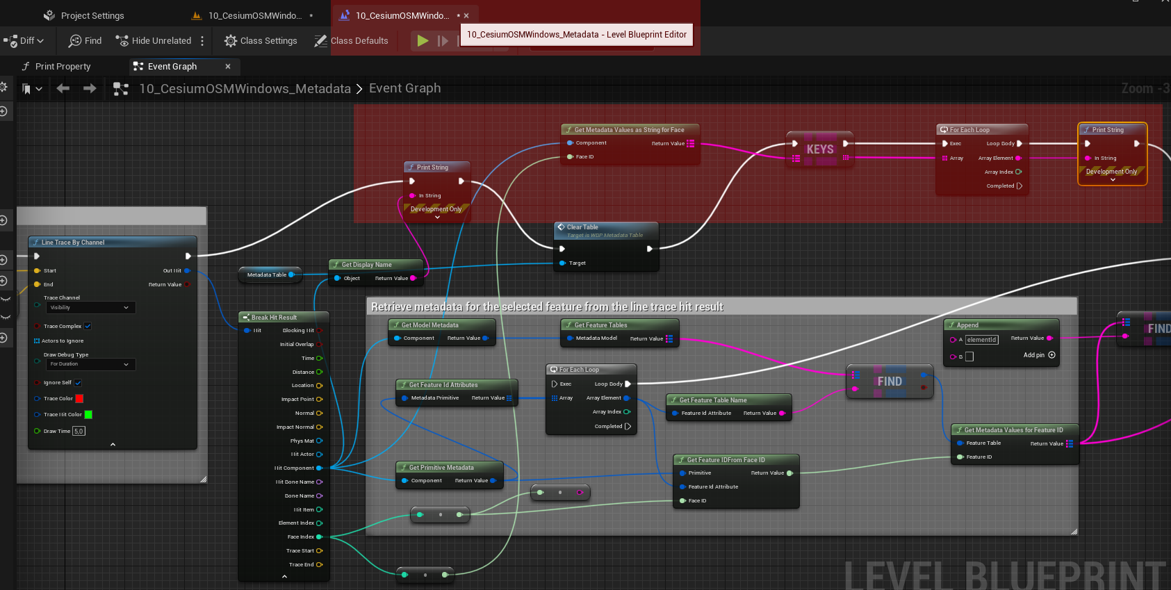

- How can you print attributes of OSM Cesium metadata:
- download example project:
Cesium for Unreal Samples in Blueprints - UE Marketplace - Open map 10_CesiumOSMWindows_Metadata, and add print instruction in level Blueprint:
- Now play proejct and click on buldings. This is sample LOG for You:
LogBlueprintUserMessages: [10_CesiumOSMWindows_Metadata_C_1] Cesium OSM Buildings.https://assets.ion.cesium.com/us-east-1/asset_depot/96188/OpenStreetMap/2023-01-02/12/4400/852.b3dm?v=16 mesh 0 primitive 0 https://assets.ion.cesium.com/us-east-1/asset_depot/96188/OpenStreetMap/2023-01-02/12/4400/852.b3dm?v=16 mesh 0 primitive 0

LogBlueprintUserMessages: [10_CesiumOSMWindows_Metadata_C_1] building:name
LogBlueprintUserMessages: [10_CesiumOSMWindows_Metadata_C_1] contact:email
LogBlueprintUserMessages: [10_CesiumOSMWindows_Metadata_C_1] smoking
LogBlueprintUserMessages: [10_CesiumOSMWindows_Metadata_C_1] air_conditioning
LogBlueprintUserMessages: [10_CesiumOSMWindows_Metadata_C_1] short_name
LogBlueprintUserMessages: [10_CesiumOSMWindows_Metadata_C_1] wikimedia_commons
LogBlueprintUserMessages: [10_CesiumOSMWindows_Metadata_C_1] historic:railway
LogBlueprintUserMessages: [10_CesiumOSMWindows_Metadata_C_1] lunch
LogBlueprintUserMessages: [10_CesiumOSMWindows_Metadata_C_1] self_service
LogBlueprintUserMessages: [10_CesiumOSMWindows_Metadata_C_1] building:parts
LogBlueprintUserMessages: [10_CesiumOSMWindows_Metadata_C_1] man_made
LogBlueprintUserMessages: [10_CesiumOSMWindows_Metadata_C_1] product
LogBlueprintUserMessages: [10_CesiumOSMWindows_Metadata_C_1] architect:wikidata
LogBlueprintUserMessages: [10_CesiumOSMWindows_Metadata_C_1] official_name
LogBlueprintUserMessages: [10_CesiumOSMWindows_Metadata_C_1] building:architecture
LogBlueprintUserMessages: [10_CesiumOSMWindows_Metadata_C_1] name:ja
LogBlueprintUserMessages: [10_CesiumOSMWindows_Metadata_C_1] name:ko
LogBlueprintUserMessages: [10_CesiumOSMWindows_Metadata_C_1] name:lv
LogBlueprintUserMessages: [10_CesiumOSMWindows_Metadata_C_1] name:pt
LogBlueprintUserMessages: [10_CesiumOSMWindows_Metadata_C_1] part#source
LogBlueprintUserMessages: [10_CesiumOSMWindows_Metadata_C_1] theatre:genre
LogBlueprintUserMessages: [10_CesiumOSMWindows_Metadata_C_1] building:material
LogBlueprintUserMessages: [10_CesiumOSMWindows_Metadata_C_1] operator:wikipedia:de
LogBlueprintUserMessages: [10_CesiumOSMWindows_Metadata_C_1] musical_instrument
LogBlueprintUserMessages: [10_CesiumOSMWindows_Metadata_C_1] location
LogBlueprintUserMessages: [10_CesiumOSMWindows_Metadata_C_1] part#building:min_level
LogBlueprintUserMessages: [10_CesiumOSMWindows_Metadata_C_1] ref:bufa
LogBlueprintUserMessages: [10_CesiumOSMWindows_Metadata_C_1] surveillance
LogBlueprintUserMessages: [10_CesiumOSMWindows_Metadata_C_1] part#elementType
LogBlueprintUserMessages: [10_CesiumOSMWindows_Metadata_C_1] part#elementId
LogBlueprintUserMessages: [10_CesiumOSMWindows_Metadata_C_1] part#building:colour
LogBlueprintUserMessages: [10_CesiumOSMWindows_Metadata_C_1] part#building:part
LogBlueprintUserMessages: [10_CesiumOSMWindows_Metadata_C_1] part#building:shape
LogBlueprintUserMessages: [10_CesiumOSMWindows_Metadata_C_1] part#roof:shape
LogBlueprintUserMessages: [10_CesiumOSMWindows_Metadata_C_1] part#layer
LogBlueprintUserMessages: [10_CesiumOSMWindows_Metadata_C_1] part#start_date
LogBlueprintUserMessages: [10_CesiumOSMWindows_Metadata_C_1] part#roof:levels
LogBlueprintUserMessages: [10_CesiumOSMWindows_Metadata_C_1] part#roof:colour
LogBlueprintUserMessages: [10_CesiumOSMWindows_Metadata_C_1] part#roof:material
LogBlueprintUserMessages: [10_CesiumOSMWindows_Metadata_C_1] part#area
LogBlueprintUserMessages: [10_CesiumOSMWindows_Metadata_C_1] part#indoor
LogBlueprintUserMessages: [10_CesiumOSMWindows_Metadata_C_1] part#level
LogBlueprintUserMessages: [10_CesiumOSMWindows_Metadata_C_1] part#wheelchair
LogBlueprintUserMessages: [10_CesiumOSMWindows_Metadata_C_1] part#description
LogBlueprintUserMessages: [10_CesiumOSMWindows_Metadata_C_1] part#type
LogBlueprintUserMessages: [10_CesiumOSMWindows_Metadata_C_1] part#building:material
LogBlueprintUserMessages: [10_CesiumOSMWindows_Metadata_C_1] part#roof:height
LogBlueprintUserMessages: [10_CesiumOSMWindows_Metadata_C_1] part#roof:orientation
LogBlueprintUserMessages: [10_CesiumOSMWindows_Metadata_C_1] part#roof:direction
LogBlueprintUserMessages: [10_CesiumOSMWindows_Metadata_C_1] part#levelpart
LogBlueprintUserMessages: [10_CesiumOSMWindows_Metadata_C_1] part#lit
LogBlueprintUserMessages: [10_CesiumOSMWindows_Metadata_C_1] part#bridge
LogBlueprintUserMessages: [10_CesiumOSMWindows_Metadata_C_1] part#addr:city
LogBlueprintUserMessages: [10_CesiumOSMWindows_Metadata_C_1] part#addr:housenumber
LogBlueprintUserMessages: [10_CesiumOSMWindows_Metadata_C_1] part#addr:postcode
LogBlueprintUserMessages: [10_CesiumOSMWindows_Metadata_C_1] part#email
LogBlueprintUserMessages: [10_CesiumOSMWindows_Metadata_C_1] part#phone
LogBlueprintUserMessages: [10_CesiumOSMWindows_Metadata_C_1] part#website
LogBlueprintUserMessages: [10_CesiumOSMWindows_Metadata_C_1] part#smoking
LogBlueprintUserMessages: [10_CesiumOSMWindows_Metadata_C_1] part#building:roof
LogBlueprintUserMessages: [10_CesiumOSMWindows_Metadata_C_1] cesium#color
but not all metadata may be present in all buildings!
- How found metadata in own b3dm model?
- open example with metadata object. This is nice example:
Cesium Sandcastle - click F12 and download any model b3dm with metadata:
https://assets.ion.cesium.com/us-east-1/asset_depot/75343/NYCDoITT/v1/5/9/23.b3dm?v=2 - open model in notepad and look batch header table. First line look like this. You can fine metadata like Heigh and other:
{"BATCH_LENGTH":162,"RTC_CENTER":[1338240.818463742,-4649962.016111534,4141497.3741141693]} {"BIN":["4000654","4000603","4005185","4000605","4005179","4000648","4000650","4000643","4000652","4005186","4541852","4518907","4000656","4000661","4000659","4005177","4000695","4550077","4000696","4518751","4000671","4000685","4000670","4005269","4005280","4005277","4000000","4541855","4005272","4436808","4005162","4005077","4005169","4005069","4518906","4595582","4000672","4005267","4595567","4000674","4005171","4000000","4433418","4595554","4433420","4433393","4433414","4433421","4433395","4595568","4433412","4441794","4595570","4441796","4000600","4433390","4000682","4000683","4000601","4000607","4307108","4000658","4005181","4539429","4005187","4005157","4005189","4005191","4005193","4005194","4005197","4005195","4005067","4005068","4005200","4005198","4005072","4005265","4005076","4433416","4433396","4433391","4595564","4433398","4433422","4433392","4000639","4000606","4000644","4000642","4441798","4000653","4000657","4594899","4000647","4595555","4000649","4595569","4595557","4595571","4005178","4595588","4000602","4000604","4000655","4542032","4005180","4433417","4433419","4000651","4595556","4000637","4433415","4000667","4433413","4538623","4000660","4441793","4436627","4436807","4433411","4000675","4005281","4441795","4595566","4000676","4005073","4005278","4005270","4441797","4000680","4000686","4433385","4000673","4005266","4005271","4436809","4005170","4000684","4000608","4539937","4000668","4005192","4539949","4005188","4005196","4005075","4433394","4000646","4000666","4000641","4315134","4005279","4000681","4005071","4005080","4005268","4005282","4000640","4000645","4005176","4000638"],"DOITT_ID":["743063","373823","621538","363753","9240","241486","355120","437702","659298","566934","259372","947563","522376","430867","721382","156934","7043","1023856","226687","947515","671130","569478","801107","852989","175988","442111","1219706","1057270","829076","805101","402645","679665","521082","277180","1227269","581658","292050","455101","154243","431862","526332","0","1261099","1261094","1261100","1261126","446541","1261096","1261128","704040","1261114","298196","541580","1261090","21104","763218","169297","671941","498188","18116","1115273","830709","1116249","1109597","802835","1017559","755314","271293","489430","717292","690180","828639","43264","178237","767347","753092","442347","60225","64747","1261093","1261125","1261122","1261109","1261123","1261095","1261129","845139","424949","596438","514925","1261091","399492","672867","1262237","145590","29993","537892","1261130","488998","1261124","287260","797550","488135","414714","724","1263572","230441","1261098","52681","384646","1261097","77732","1261113","628206","1261112","1110541","481610","1261089","312541","18819","1261111","620735","679106","1261088","1261121","40384","303723","595438","767485","1261087","397059","845585","1261076","202456","684467","425866","32513","601054","668727","470286","680029","178062","285104","1114250","772815","713413","420606","1261127","477490","278586","8520","160444","37841","615555","664705","570989","441055","802979","390582","589157","80432","274742"],"Height":[9.296659274928981,11.882004753587546,6.706037433909706,16.382812436556982,17.005435154271634,10.978429903540306,9.395414685828221,11.377654866521535,9.333509622763081,19.29573465080423,3.2590793950807484,2.6886763770397915,8.79233485984568,5.367042866317903,5.204375721303093,9.495600334870726,11.559469889167659,4.056621409520757,8.786410977181815,6.67098664406364,10.349684488469236,8.65051227703458,10.424787244583195,6.202053746187672,5.9582264400471185,5.392062340546367,4.1147468592537,4.008644067960925,6.088230844546758,6.387996222167301,6.97113729374395,5.891272420813387,13.058967935909422,3.312541362760798,4.062168643121463,4.967483541126365,10.206031855814425,5.132241716453823,5.8817641954070305,5.432155217121163,4.556236315675224,3.510202552984982,20.25506695846944,20.755640567748017,20.00689856438057,19.424089386152904,21.088239739411428,20.28109692621009,19.98083817908529,21.166268729421084,21.01277053820857,21.631302681574134,20.519207498411973,21.236007035173763,10.304970802036646,4.752231818628872,11.263052762598395,9.422237841223238,14.247232245205627,10.013339379033251,204.28177520223548,10.214904368577471,30.833202813821732,72.74867484563285,13.464421036214825,75.41041099639384,9.08872744062993,13.161143432829162,34.0814593793854,29.773982671434613,12.23328347010163,21.90855933523767,21.80360283621154,5.935642345252364,12.961579338697865,17.69227342590672,8.83378343268465,6.79342468718556,33.38623656356901,17.512164590188522,20.24863593994189,20.96644097510025,20.437489161934092,18.62020722875478,18.410077100241356,18.246826323885387,11.448978672956986,16.40414902556555,11.369699494123529,11.33516562149374,18.357955743354207,9.313301515924348,9.673273300340776,22.796641036235002,11.340409962191625,18.806653823348324,11.022228973833386,19.04296524537515,17.71241995607153,18.40715136249508,5.342329891542369,17.607324725491427,6.539400537767557,16.355046810229453,8.937176327458765,28.042103228282897,9.428183028577232,20.653441697176113,20.380401294008713,9.333509771774693,19.65223263991831,11.38131269781169,20.342849787462463,8.704341279054397,20.26290063207015,6.8304103176891555,12.410410980802098,20.639695187197738,4.4230794062544625,4.4604192631535975,20.847782542897,10.255074380414818,5.341754422959573,20.187310086617646,21.39547865144442,10.28918145663536,3.6082983652859904,5.5237237171563525,6.563292775553099,21.817292307882013,11.479979057551107,8.72988244347701,22.10715758466005,12.29352185862463,4.326580684457428,6.613452094743375,31.290708660503036,4.478068430324275,8.706809744049666,9.535472756872107,28.499028327508178,10.754797029097842,19.72918641517797,140.02359819610666,17.749239543417744,17.313704213215136,15.325931322163392,20.43075400554803,11.389238804712846,8.78264253899789,11.547489404129642,7.119924587634821,5.567659198528095,11.730733109858564,8.54856447155317,20.076644396983756,10.050015501303331,5.604660937565491,11.451446974888775,11.400028494024127,3.6508701816962352,11.381312137621162],"Latitude":[40.74727297306063,40.74688022994278,40.74832770462048,40.74689952843336,40.7479532260683,40.74716897439006,40.74706105358452,40.74719434085078,40.74716719430126,40.74825094033804,40.750332390326484,40.74809212525165,40.74746612359324,40.74759653890381,40.747488438402684,40.74793505549515,40.746859768472945,40.746648295491255,40.74667591294119,40.74743402632042,40.74735003243585,40.74666211616656,40.74745387224504,40.751628013498774,40.75248139045984,40.75198204354246,40.75148813856178,40.74959382704793,40.75202508534133,40.749074895472944,40.74871552956423,40.74990048481684,40.7477716797868,40.751184847089505,40.74974152512353,40.75515841962643,40.747242256226144,40.75109546657199,40.75486887984639,40.74729726344574,40.74813292550558,40.749485143635575,40.753270313073884,40.753508810920465,40.7535343909497,40.7538133352719,40.754056096046064,40.7540837897231,40.75408771404524,40.75428888591087,40.754320901009265,40.754511103977734,40.754786207752254,40.75477999291565,40.74664699710116,40.75481814761887,40.74669053365836,40.74677033911299,40.746858870310966,40.746919074961774,40.747003061626806,40.74749628370075,40.748044810062524,40.74789443207057,40.74865125797877,40.74848173825267,40.74887141595089,40.74914887561184,40.749498209800194,40.74963872928743,40.74975996691099,40.74954124848243,40.75004692428425,40.7502132879086,40.750429328540605,40.75010688686145,40.75059216060395,40.75098927498802,40.75127184314276,40.75372250257019,40.754273464927735,40.754794301765365,40.75514670746705,40.75470648267174,40.753873514754844,40.75437444773115,40.74724454328825,40.74691008019137,40.74718297168434,40.74720551094131,40.75510819740834,40.74721959928893,40.74751199043787,40.75259991686586,40.747162561688306,40.75342378758284,40.74714589568212,40.754092022450294,40.7541706583253,40.75498383726094,40.74799038570983,40.75465347051229,40.74680524628773,40.74688686223849,40.74733338043898,40.75249575331977,40.747973589767774,40.75307424449613,40.75334815035338,40.74711447328418,40.75360687430593,40.74727200504801,40.75398450700668,40.74753468596112,40.75424218306092,40.748378853944466,40.74754015560288,40.75431315055103,40.7467408491475,40.74838960854603,40.754518052115934,40.747400897115966,40.751729039411416,40.75459296133056,40.75475771887838,40.74729711357419,40.75067620859743,40.752169514323235,40.751865578519265,40.754853260171664,40.74665484315355,40.74660998010435,40.75511001114868,40.74737565937305,40.75097965130646,40.75217332983972,40.74928096155264,40.74798087638334,40.746714619365065,40.7469432516825,40.747119461612385,40.7474972245806,40.74893135411082,40.74865076719817,40.748905446980686,40.74965134815906,40.75128982604205,40.75400863758686,40.74716928723337,40.747398244591224,40.74721846383912,40.746747865530835,40.752330960246624,40.74667041916731,40.75046157128525,40.74938347142244,40.7512309769835,40.751551311892655,40.747231833295345,40.747182586599536,40.74792363925225,40.74725850573098],""]}
But You cant easy change this data! This is binary format and have checksum :/.
