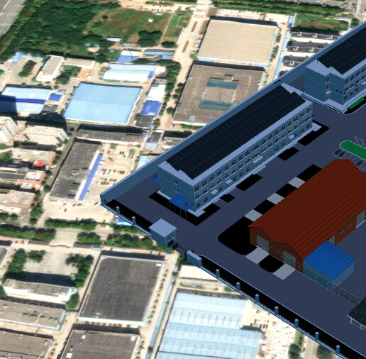

How can we increase the brightness of the model?
I loaded the model into the scene. I don’t want it to be affected by the sunlight because it would create shadows on both sides, which looks very unattractive. How can I increase the brightness of the model without affecting the map tiles?
Or how can we make the model look more normal instead of looking ugly?

Perhaps I didn’t express myself clearly. Let’s start with the first question: How can we ensure that the model remains bright without being affected by the lighting in the scene, and also eliminate the shadows on the model? thank you
I think the first place to start would probably be KHR_materials_unlit, which is intended for that purpose. Assuming you’re loading a glTF model, it can be converted to unlit with:
npm install --global @gltf-transform/cli
gltf-transform unlit in.glb out.glb
If that isn’t working for you, more information about the model might be necessary.
Based on https://github.com/CesiumGS/cesium/pull/6977, I believe unlit shading disables scene lighting, but currently does not disable shadows.
