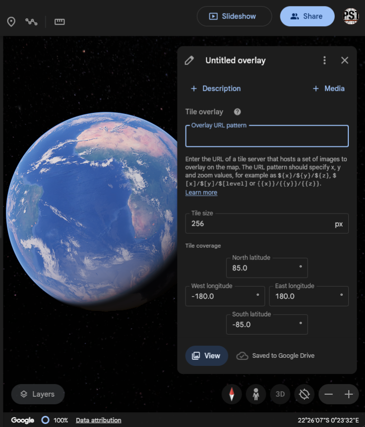

I have used the sandcastle to import raster tiff onto the globe which is displaying well. The project I am building in Google earth web (see image) lets you enter the URL of a tile server, I am wondering can I use cesium ion as the tile server? and where would I find the relevant URL within Cesium?
Cesium can stream imagery data as either a WMTS or TMS imagery provider.
To find the URL you will need to use the ion REST API, specifically the GET asset endpoint route. This will provide you with the base URL to use for either of those services.
Two important thing to note is that it will also provide an access token which must be sent along with the request for imagery. This token also has a limited duration of approximately and hour and must be re-requested with the GET asset endpoint route if it expires.
