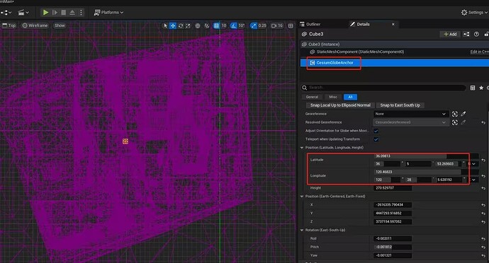

(1) Using TopView, place a Cube at the center of the Cesium3DTileset to be rotated, and then add a Cesium Globe Anchor to obtain the latitude and longitude of the position (i.e. the center of Cesium3DTileset).

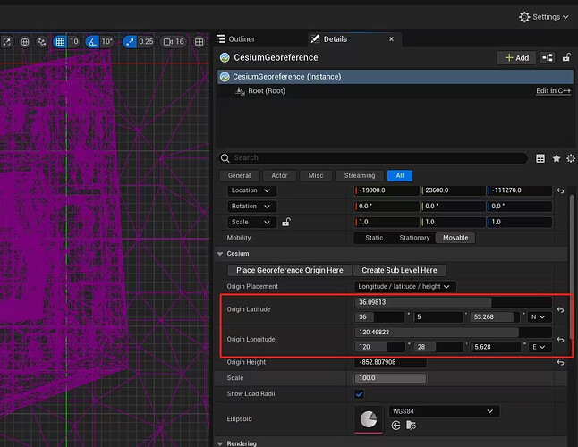

(2) Add a CesiumGeoreference to the Outliner (set Origin lat, lng to the latitude and longitude of the Cesium Globe Anchor in step (1). Height can be set to a suitable value , as rotation is usually along the Z-axis and the value of Z does not matter.

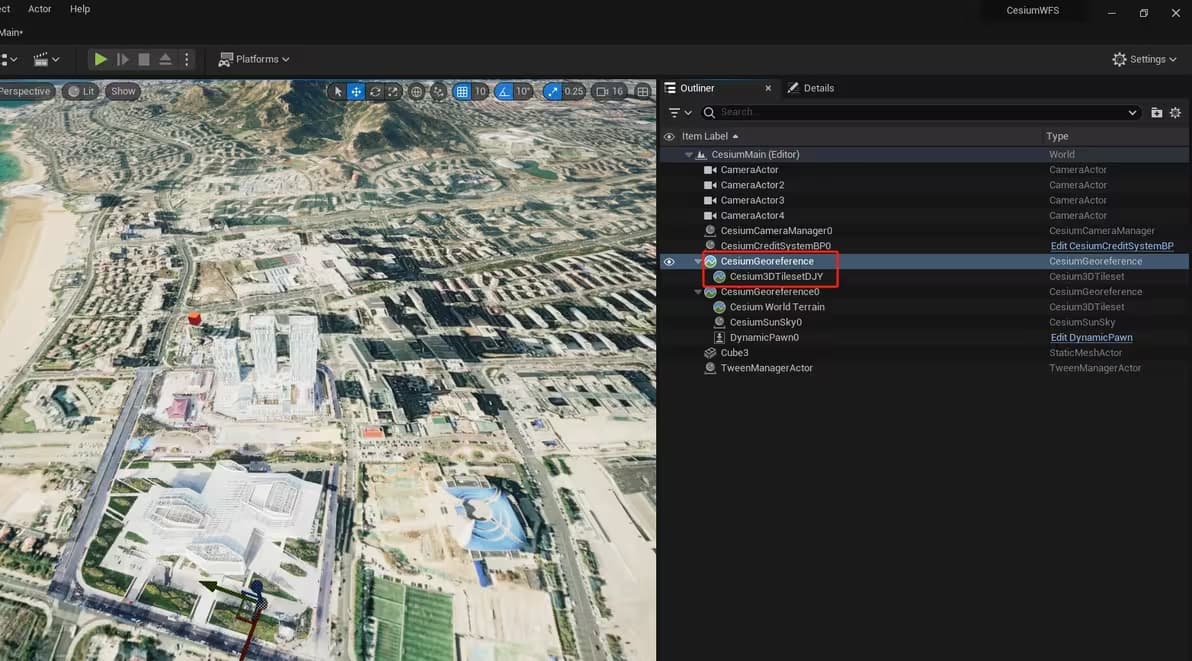

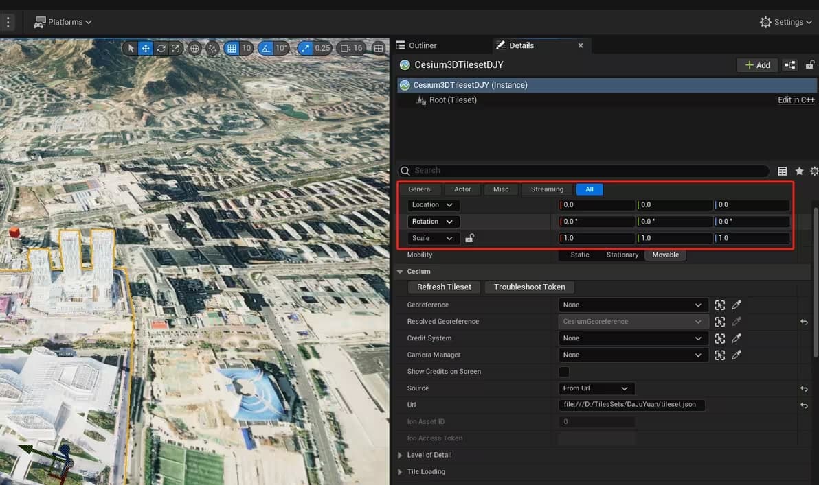

(3) Attach Cesium3DTileset to CesiumGeoreference, and then reset the Transform of Cesium3DTileset. At this point, Cesium3DTileset will be offset from its original position, and the next step will be to correct it.

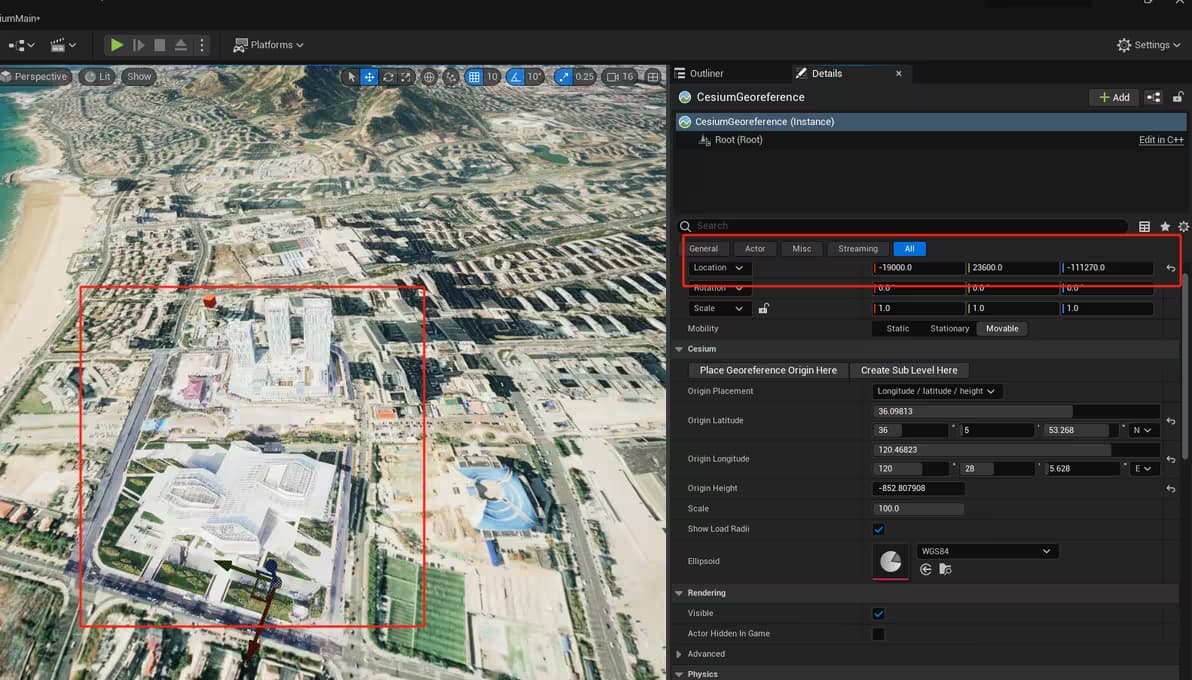

(4) Move CesiumGeoreference until Cesium3DTileset is aligned to its original position.

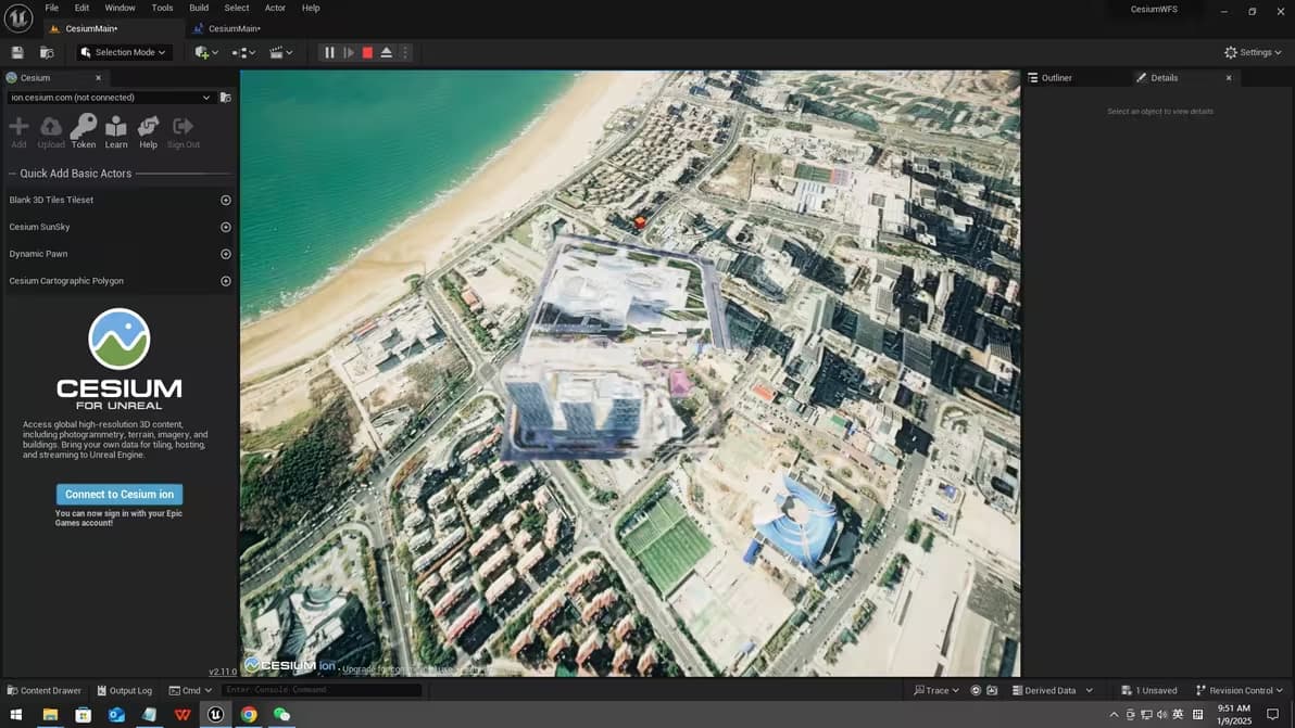

(5)Now to control the rotation and scaling of Cesium3DTileset is to control the rotation and scaling of the CesiumGeoreference.
