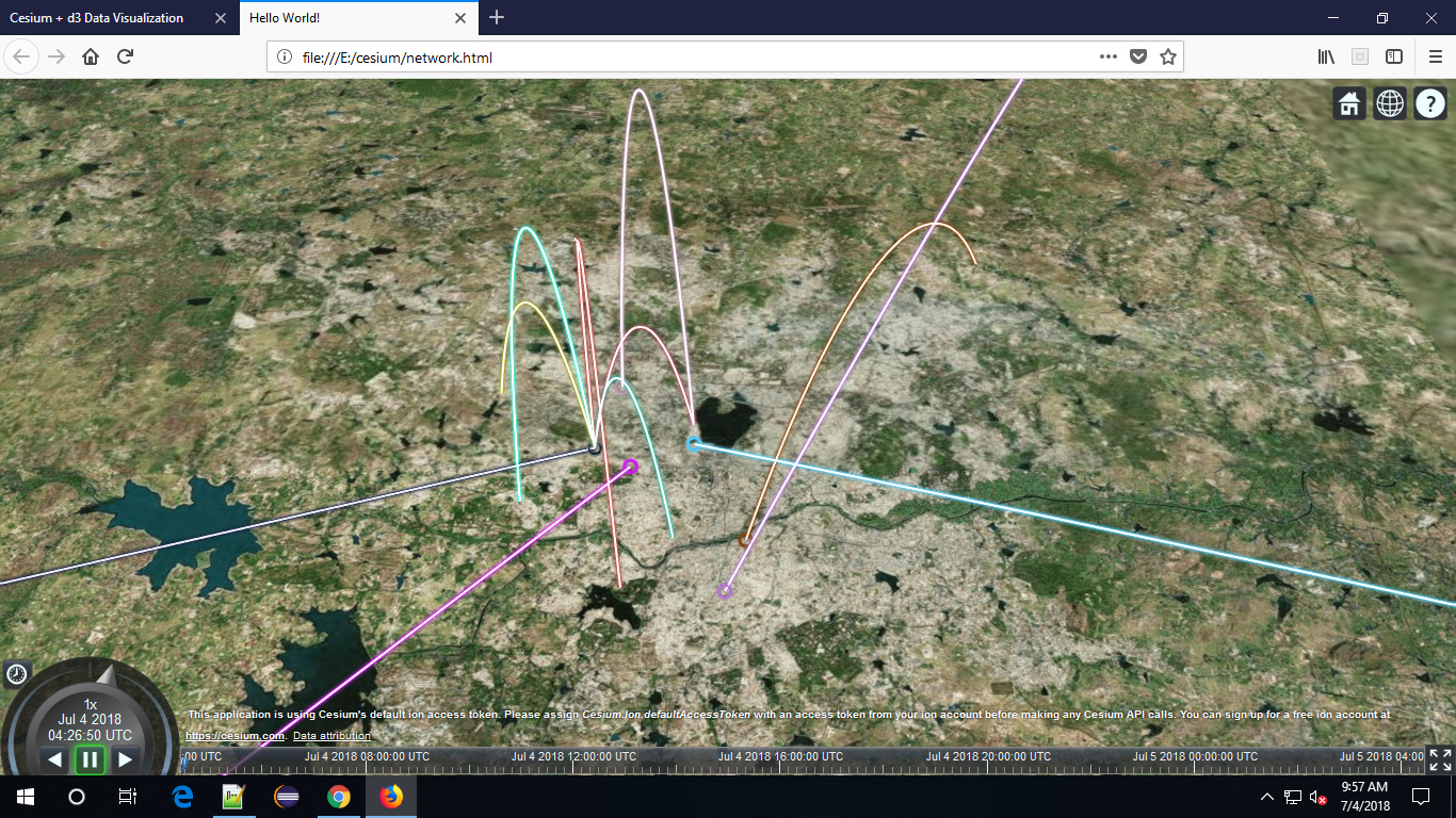

i am creating a network type data using the arc connecting the places.I want to cluster the data according to the location we move.

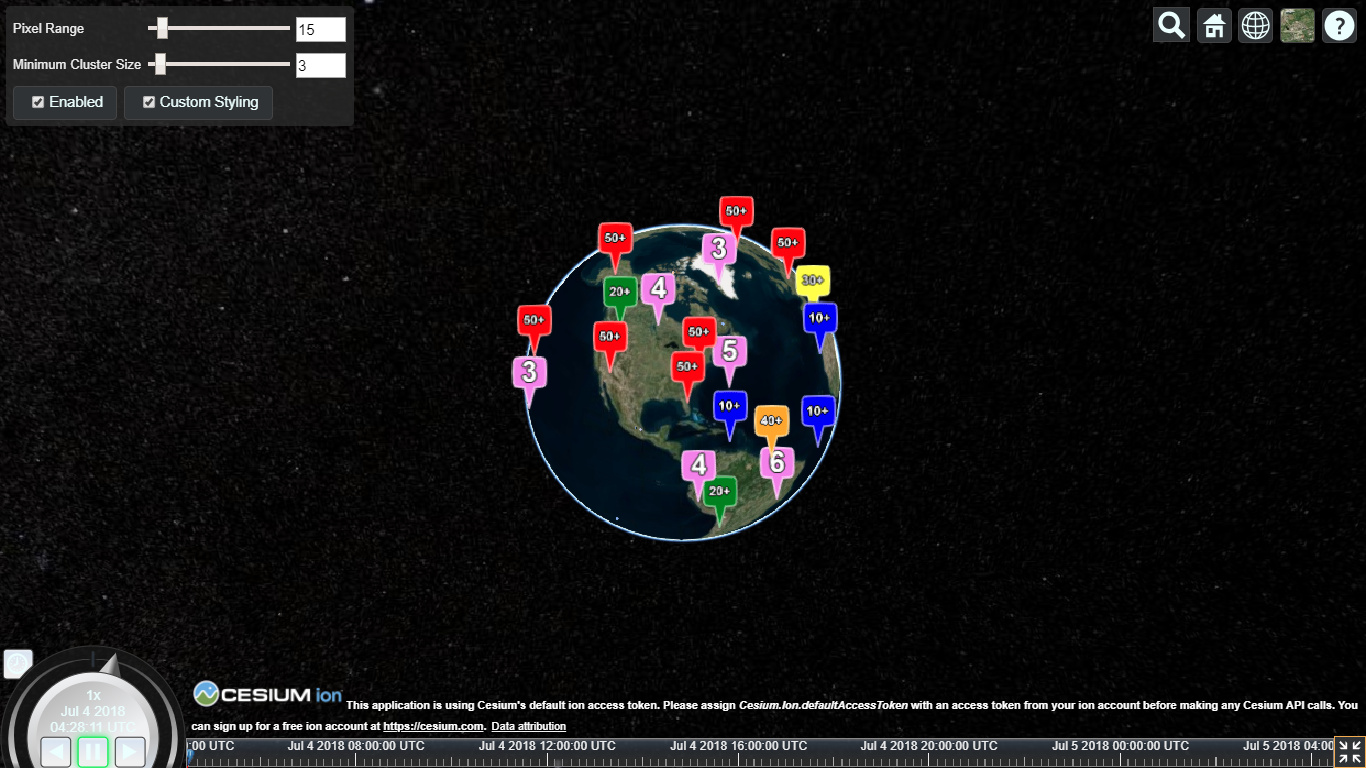

i am trying my solution to do in this way by using the polygons and arcs(https://cesiumjs.org/Cesium/Build/Apps/Sandcastle/?src=Clustering.html)
Thanks,
Arun
So clustering only applies to billboards, points, and labels. However, it should be fairly straightforward to add an additional billboard (or point, or label) entity on each arc. Then set the DistanceDisplayCondition on each type of entity, so that when the camera is far away, the arcs are hidden and the billboards (or points, or labels) are shown, and clustered just like the Sandcastle example.
