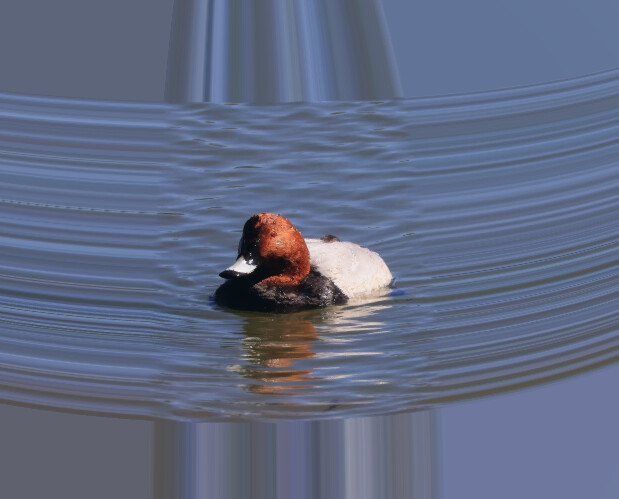

In this demo, when I use my photo, the photo there will be ​​Edge stretching​
It looks like the texture wrap mode is REPEAT by default, meaning that it will just repeat the last pixel from the border, along each direction.
Depending on the exact use-case and requirements, ther may be different options for solving that. It might be possible to change this wrap mode, but I have doubts that this will be possible on the API level. An easy solution could be to just add a one-pixel transparent border to the image, like this one:
The result, using this exact image, is shown here:
Will also add that, if you don’t need the image to conform to terrain or anything, you could simply use a rectangle with an ImageMaterialProperty instead (example).

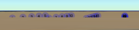

When I use entity ImageMaterialProperty
The primitive point and label Content not fully displayed, It is even invisible from certain angles
