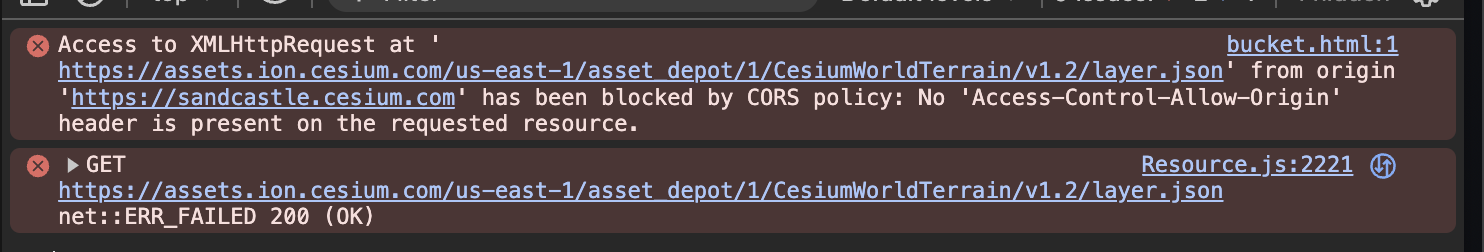

I’ve been seeing some inconsistent cors issues when fetching https://assets.ion.cesium.com/us-east-1/asset_depot/1/CesiumWorldTerrain/v1.2/layer.json Preflight works fine but actual fetching fails with a CORS error.
I’m also seeing it in sandcastle’s as well ex. Cesium Sandcastle
This alert pops up while loading
I disabled all extensions to verify and I sometimes see the layer.json file being fetched correctly and when it gets cached, it works fine afterwards.

Thank you for reporting this behavior. We are aware of this issue and are actively working on fixing it. We had an issue with some of our data products. While that issue has been resolved, there may be some old cached requests in our CDN serving stale requests. We are working on invalidating those cached requests.
