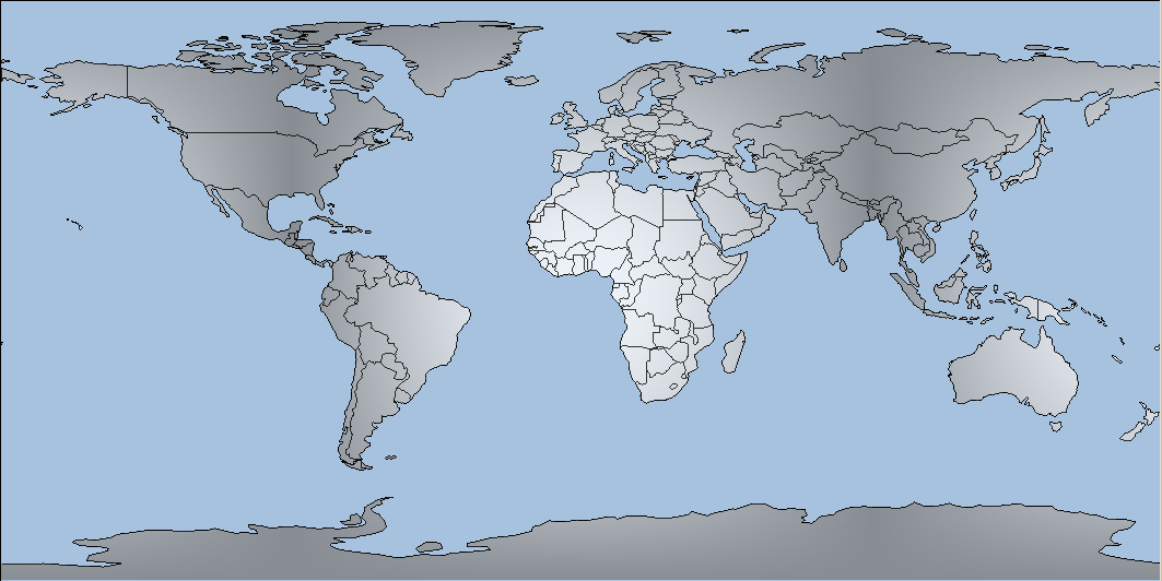

Can anyone help me to fix this issue?
Polygon should have solid color , but something effecting these polygons like some sort of darker lightning effect above it.
Its shown like below:
Appreciate for helping me.
As far as I know, there is no simple solution to this problem. We have a long term roadmap to refactor the lighting system but no ETA as to when it will happen.
Is it cause by shading effect by phong.js phong.glsl ? i read last issue about lightning that good for 3D view but not for 2D and columbus.
Can you guide me to disabling the shader? i just need the polygon color to be full color no lighting effect even on 3D.

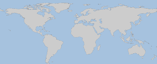

after i rebuild the source, the result still not changes.
is it me wrong on rebuild the source?
i do the rebuild with “.\Tools\apache-ant-1.8.2\bin\ant release” ,
we change the phong.glsl file right? is there any other step before do the release build?
here is the result on my last rebuild:
Pada Rabu, 19 Agustus 2015 21.59.07 UTC+8, Matthew Amato menulis:
i realize the problem of color is fixed already, then it success to rebuild!
i got it mistaken on giving .withAlpha to color of material.
but now other problem of polyline that between two polygon is missing, maybe get hide below polygons?
