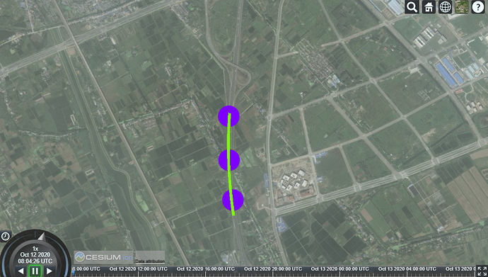

Based on PrimitiveCollection API, I have lower the polyline geometry to the bottom of the viewer.primitives and raised the billboardCollection to the top of the viewer.primitives.However, if I change the camera’s pitch to -90°(looking at the ground), i will see polyline geometry sometimes are drawn under the billboardCollection.
Just a small clarification: you mean that the polyline is drawn over the spheres when you change the camera’s pitch to -90 degrees? And you would like the polyline to be drawn under the spheres at all times, is that correct?
yes,that’s what i need.And today i have tried using GroundPolylinePrimitive and GroundPolylineGeometry API to add polylines, the polyline is drawn over the spheres all time but it takes more time to draw polyline on globe and the fps is less than 15 when i move the map.Does it need more time to calculate?
