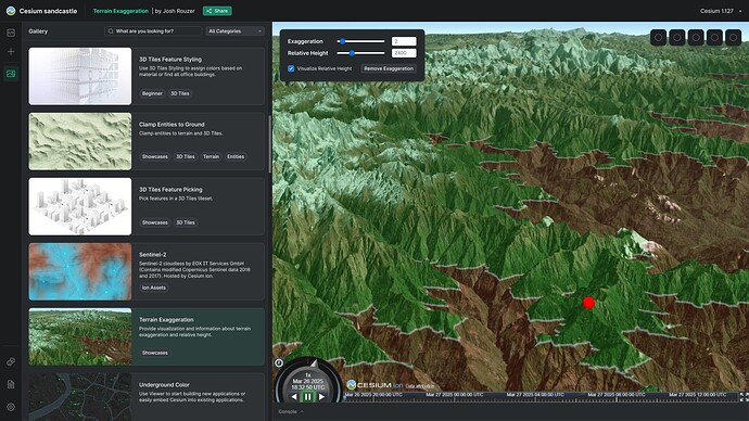

Redesigning Sandcastle: Requesting Feedback!
We’re getting close to finalizing the new UI design for Sandcastle as part of our upgrade to Sandcastle. We’re looking for feedback on the new layout and flow.
Couple questions to guide your thinking:
  • Overall do you like the new design?
    • Is there anything specific that caught your attention?
    • Do you feel there are any features missing or that you can’t find?

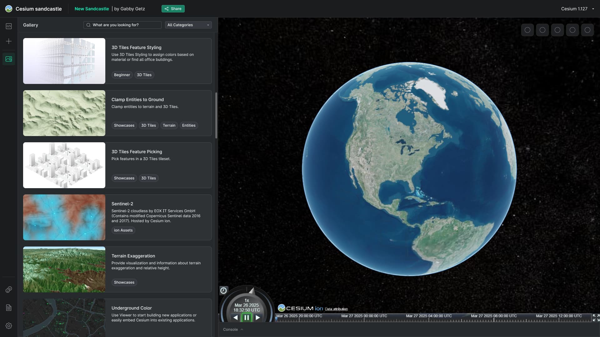

  • How do you feel about the Gallery in the Left panel covering the code?
    • The current intention is to have the gallery open by default but have an easy, one-click, way to start an empty sandcastle
  • How do you feel about the new navigation?
  • What are the top 3 reasons for using the Cesium Sandcastle in your current workflow?

I like the overall design change. Dark mode is nice and scrolling through the Sandcastles looks great.
One of my main use-cases of Sandcastle is a quick reference to “what is possible”.
For example:
Wanting to check out multiple examples in quick succession might be annoying if the Gallery is hidden by the code window. Others may disagree with this use-case.
