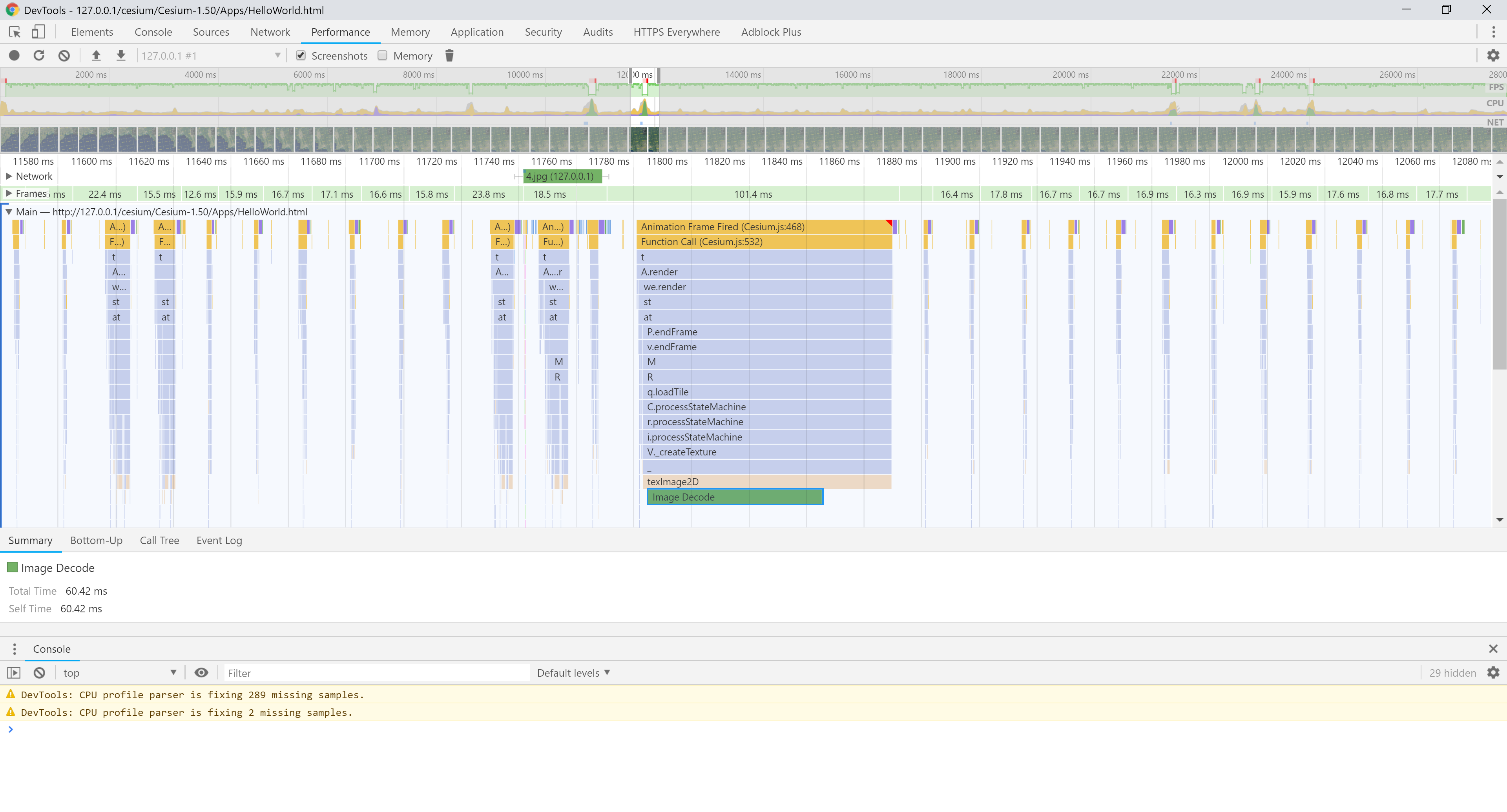

I’ve been profiling exactly what’s causing the hiccup, and the picture below tells that each time a new tile (2700 x 2700 px, 1 to 5 MB each) is loaded, the painting subroutine takes 40 to 100 ms of CPU and blocks the render loop.
I have checked that this calculation time is independant from the size of the image file (by reducing the JPEG quality), it is mainly related to the number of pixels of the image.
One solution would definitely be to load smaller tiles. But that shows that the process of tile loading is not fully asynchronous as it should be, right?
Thanks for the detailed profiling report Dorian! This sounds like the browser itself is the bottleneck here. I found this Chrome issue about the speed of texImage2D:
I think what’s happening is, WebGL calls execute in the same thread as JavaScript, so I think that’s why an expensive WebGL call freezes the context. So every time a new tile comes in, it’s drawing it to the screen that takes so long. Even if it’s just for loading, I think sometimes Cesium has to do extra steps, so for example here a texture has to be converted into a power of two texture so that’s an extra draw call:
