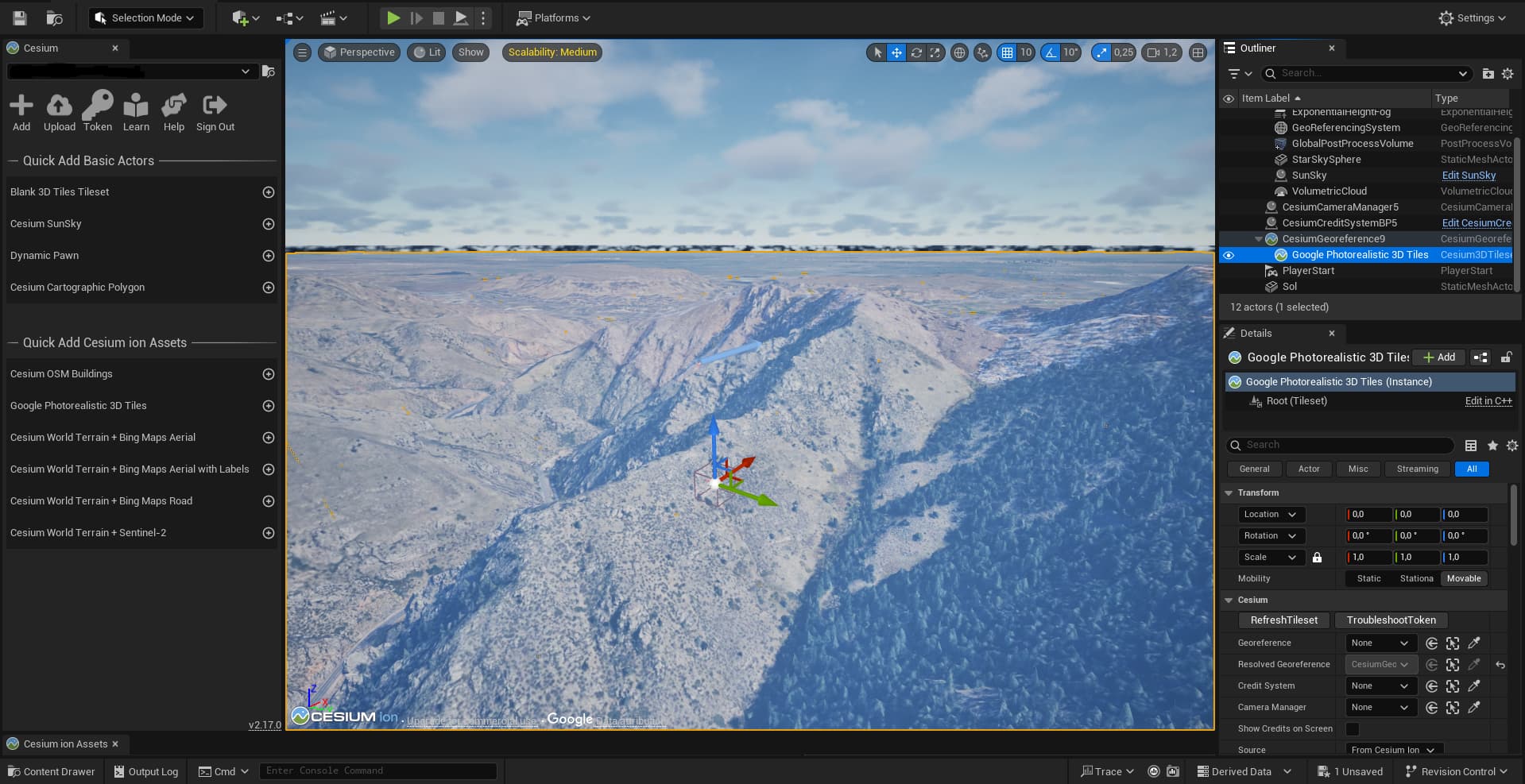

Hello,
Thank you very much for this amazin Plugin.
I’m stuck on a project. I want to choose a location according to latitude and longitude and in the first place show the specific places that are linked to those coordinates, but I can use Inaccurate Set Georeference Origin. Maybe I don’t do the correct setup.
In a second place, I want to set the surface of the map at the location that I choose to Z=0, and I can’t find out how I can do that automatically with blueprints.
Thank you for your attention
