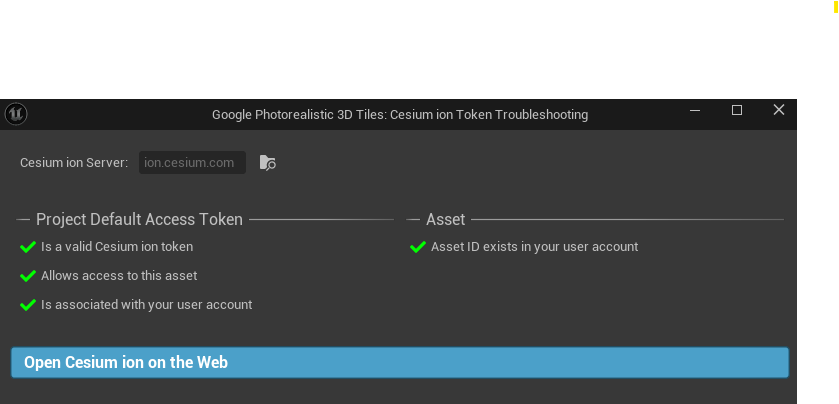

I’ve tried loading in all the Tilesets under “Quick Add Cesium ion Assets” individually. When I click the TroubleshootToken button after selecting the Tileset (in this case the Google tiles), it claims that it’s good:
And this is the output that appears in the log, which sounds like it thinks it’s successful, but nothing appears in the scene:

Thanks for getting back to us @estrube3. I realized there’s an older forum post with circumstances similar to yours; could you give the suggestions in this comment a try?
Thanks so much! I was in fact in using remote desktop and so the realtime parameter was defaulted to false. Overriding it and making it true fixed the issue! Thanks again.
