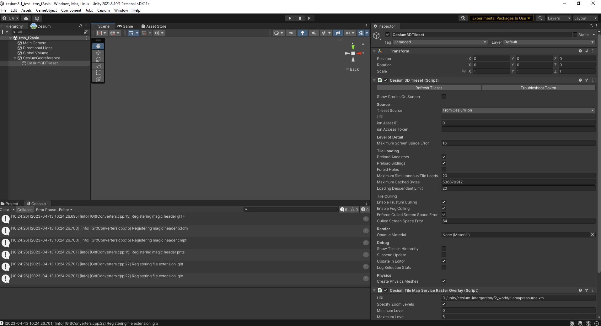

Can you screenshot the components on your game object (both tileset and overlay) so we can try to identify the problem?
here is the screenshot.
You disabled the Cesium3DTileset, so nothing will show up. Raster overlays have to “drape” over tilesets, you can’t just have them exist by themselves.

Hello I will see the link for offline. I am facing issue like I have loaded my own dataset this time from tms sevices.Note my pc has internet connection. Attaching tms file which is almost same like Natural Earth. It covers only Asia region.
Problem is my unity is not showing globe as well as data.Screen shots are attached for refrence. If u can guide me regarding this.
Your asset ID is set to 0, which is not a valid asset ID. For Cesium World Terrain, please set the ion Asset ID to 1.
I suggest you check out the Cesium for Unity Quickstart and Adding Datasets tutorials. They cover the basic information needed to load your data with Cesium for Unity.
