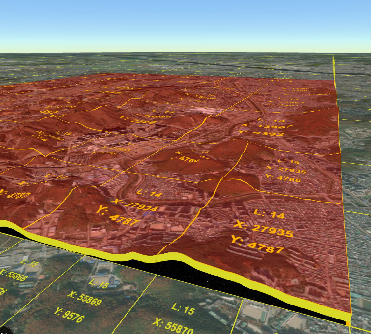

Hybrid terrain sources:
import { HybridTerrainProvider } from "@juun-roh/cesium-utils";
const provider = TerrainProvider.fromUrl("your-terrain-url");
const tiles: HybridTerrainProvider.TerrainRegion["tiles"] = new Map();
// set custom region from zoom level and tile coordinates
// Level 13, tiles covering specific geographic area
tiles.set(13, {
  x: [13963, 13967], // Tile X coordinates (west to east)
  y: [2389, 2393],   // Tile Y coordinates (north to south)
const region: HybridTerrainProvider.TerrainRegion = {
  provider,
  tiles,
const terrainProvider = new HybridTerrainProvider({
  regions: [
    // multiple regions
    region,
  defaultProvider: worldTerrain
viewer.terrainProvider = terrainProvider;
This works as:
  • worldTerrain as the default provider
  • Custom regions override specific tile coordinates at defined zoom levels of default provider.
  • Fallback to ellipsoid terrain where tile data is unavailable.
mixed terrain (ellipsoid + world)
You can see other API examples on GitHub.
