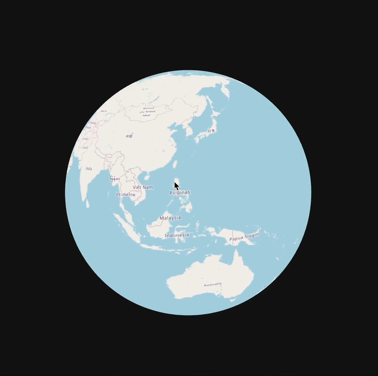

Displaying XYZ map tiles as a globe or plane. Demo.

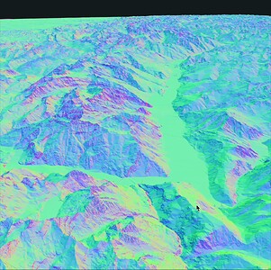

Demonstration of Swiss Terrain quantized mesh data set.

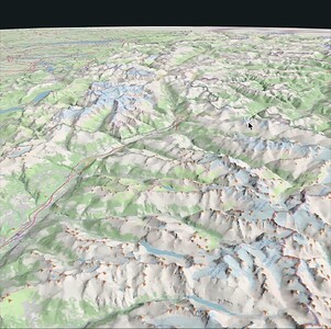

Demonstration of TMS-tiled OpenStreetMap data overlaid on top of the Swiss Terrain data set.

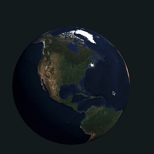

WMTS-formatted data from the NASA GIBS catalogue rendered with 3DTilesRendererJS. Demo here.
