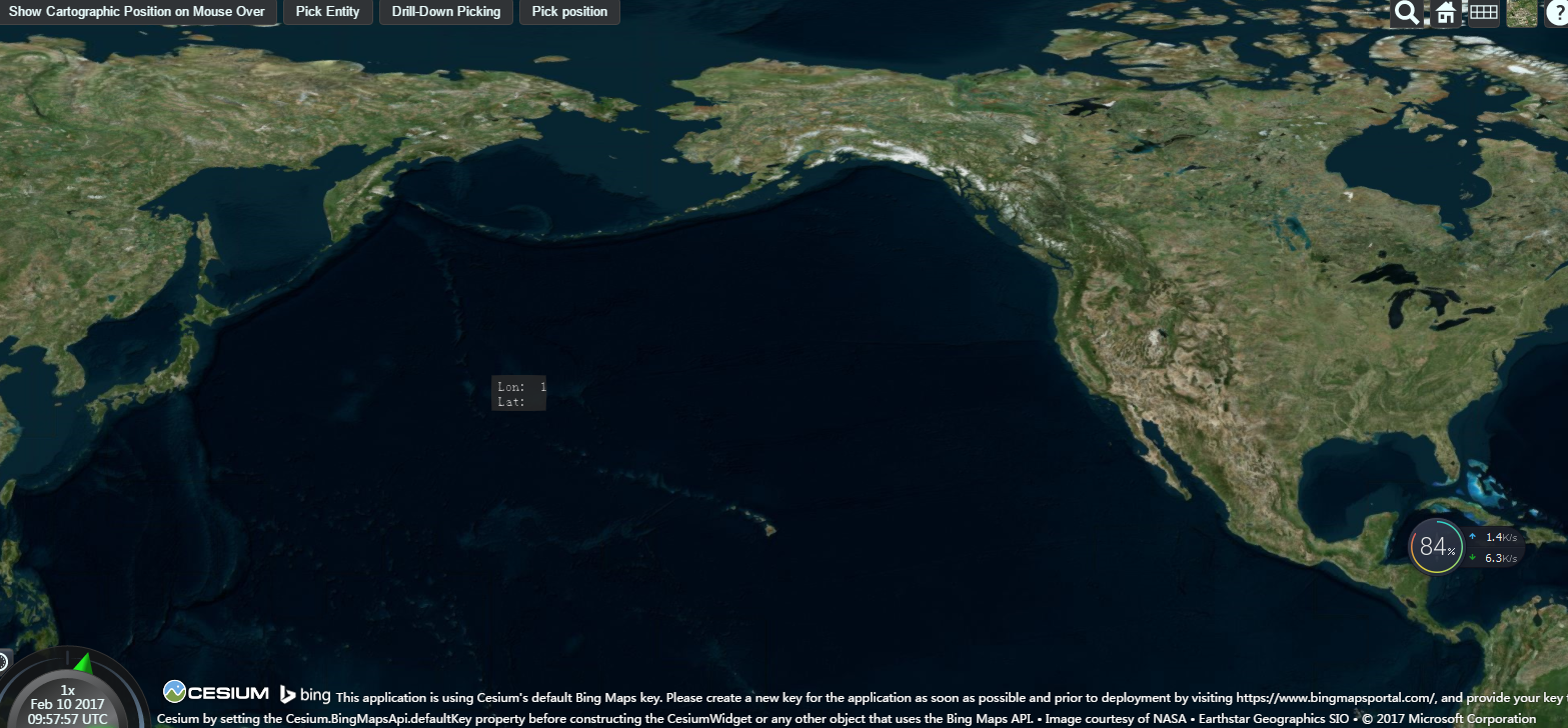

Hello, I found a bug in Picking.html. I set the earh in 2D mode,when I move mouse to 180°E,the billboard was clipped.
Could you tell me how to fix it ?Thank you.
Hello,
This is a known bug. We have an issue written up for it here: https://github.com/AnalyticalGraphicsInc/cesium/issues/3960
I posted a link to your forum post so we can give you an update when we have a chance to fix it.
Best,
Hannah
