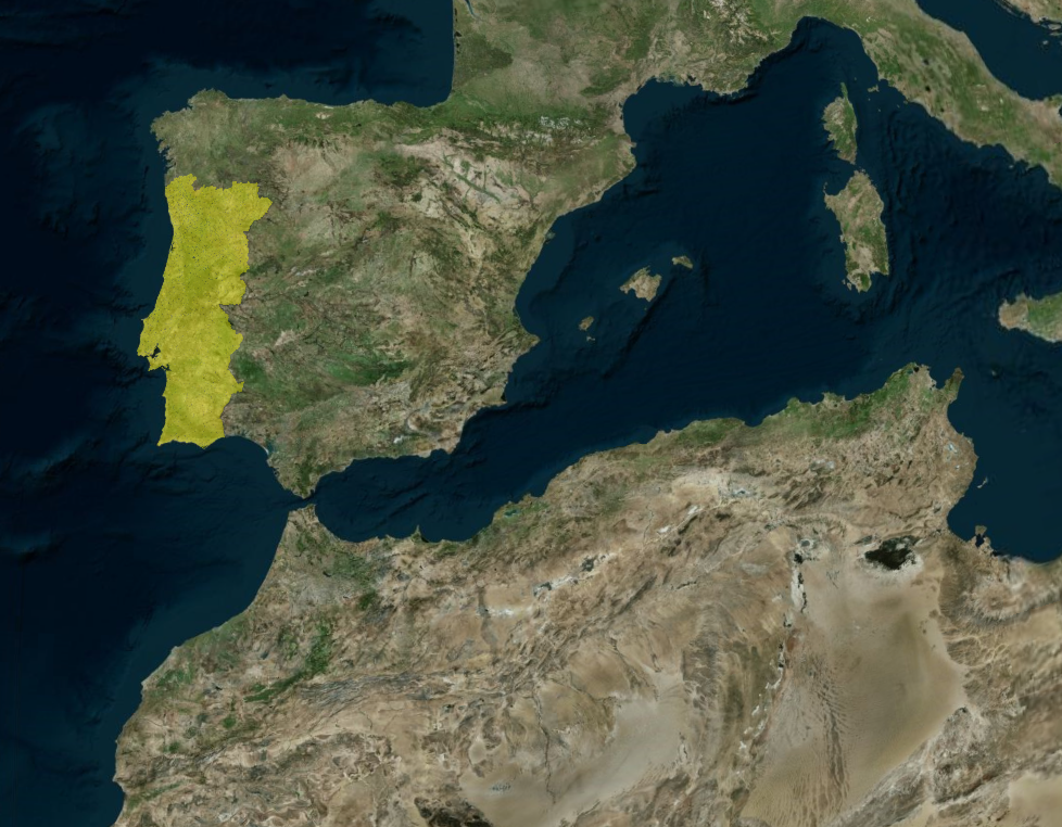

Clipping a geojson file like to implement a inverse mask
So what i want to do, its like hide all word with a mask and only show what is inside of the border of my geojson file, in this case is Portugal . I will put a image how i like to put my output vs what its my acctual output

link for output in sandcastle Sandcastle | CesiumJS
MY code

* I want to aplly the inverse clipping
Cheers , Dizz
Hi @Dizzany ,
Thanks for your post and for being part of the Cesium community.
I think what you are describing is what we call “inverse clipping”. We have a sandcastle example with an option for inverse clipping here Sandcastle | CesiumJS
Please let us know if this is what you are aiming for or if you have further questions.
Thanks,
Luke
