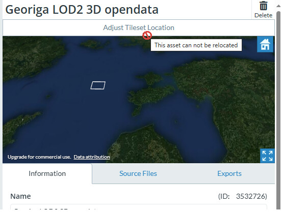

Importing these GML fles which uses EPSG:3059 the resulted data got flipped XY and asset is in wrong location. Why?
Thank you for bringing this to our attention. We’ll try to figure out what’s going wrong.
A solution has been found, and a PR created. I’ll keep you appraised of when the fix makes it into production.
So it is not data issue?

Sort of.
CityGML historically uses traditional GIS coordinate ordering, regardless of specified SRS. It’s only recently - since GDAL 3, to be specific - that data has started showing up that uses embedded ordering instead of GIS. There’s nothing in the file to suggest which is correct, though.
So it’s kinda a data issue, but it’s got history, and the app should give the user the tools to compensate for that weirdness in the wild.
The PR adds the option for the user to use the embedded SRS ordering during upload. It will hopefully be released today, after internal testing.
