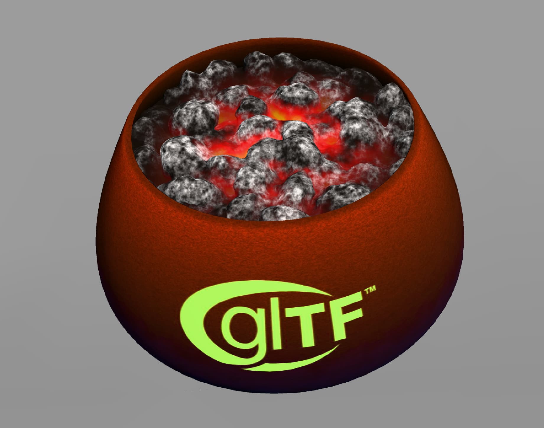

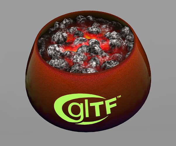

after upgrading to @cesium/engine v17, I’ve noticed that the shading model appears to change dynamically after the application has been running for a while (sometimes 30-60 seconds, depending on the resources). This shift is quite noticable and distracting. I’d prefer to either have the new shading model active from the very start or to disable it entitely. Is this expected behavior in the latest version? Is there a recommended way to control or lock the shading model so it doesn’t change during runtime?

Based on the images in your original post, it looks like what is actually delayed is the application of an environment map / image-based lighting. It might be possible for you to pre-fetch environment maps before loading any tilesets, to avoid the delay.
