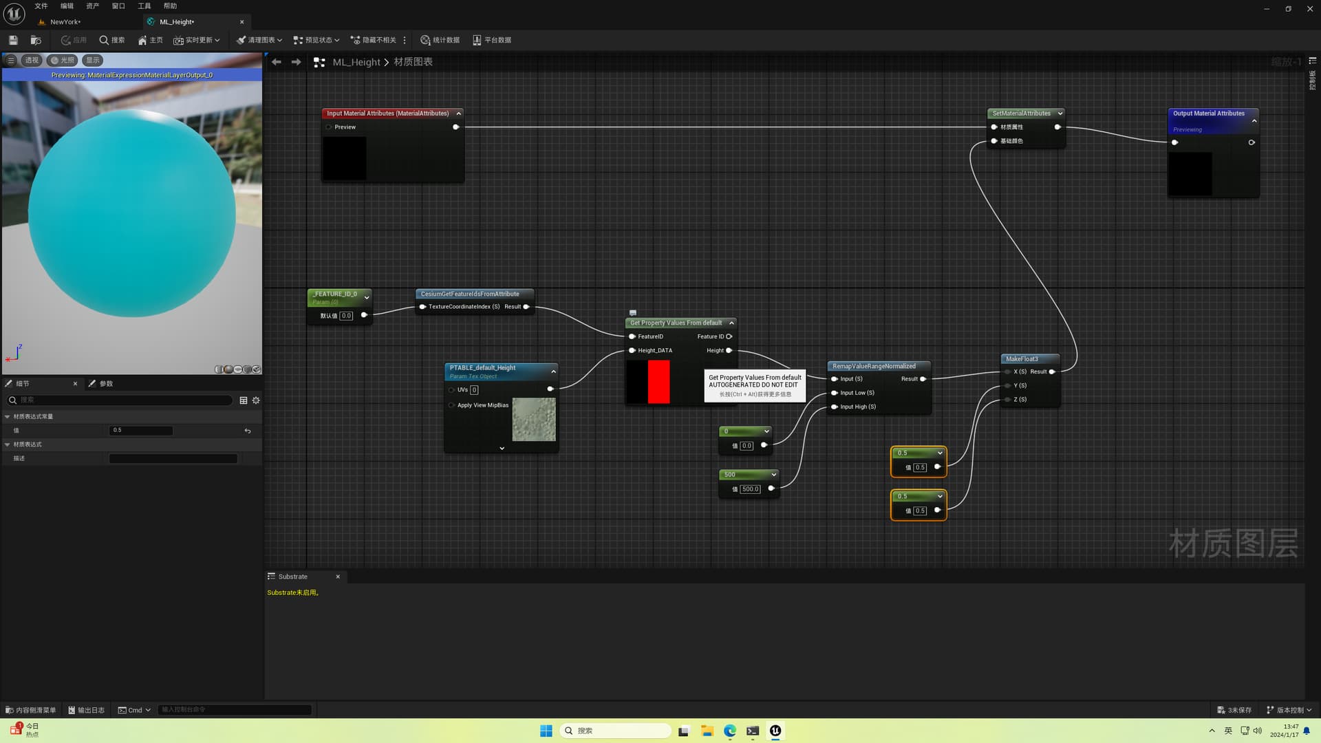

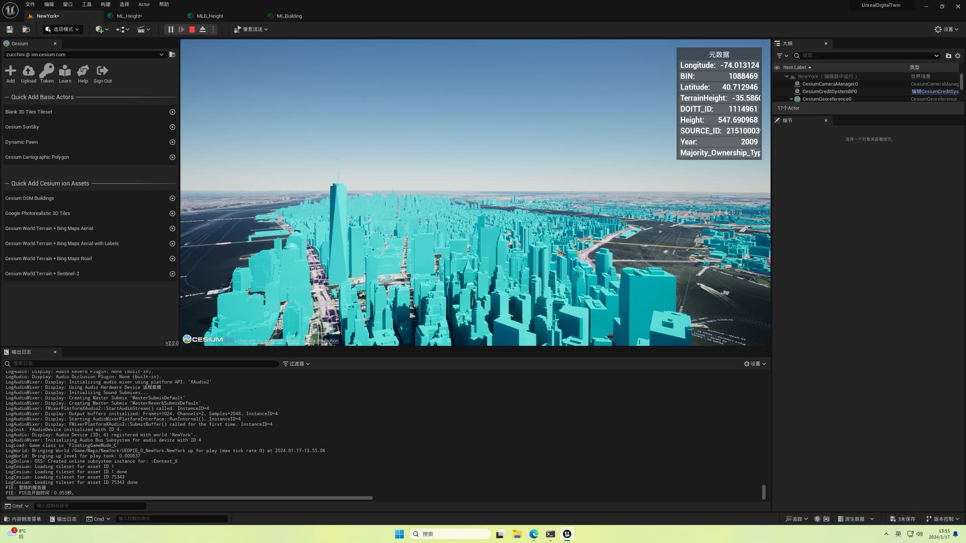

I’m trying to visualize the height property of “New York City 3D Buildings” by using CesiumFeaturesMetadata, but it fails.
I’ve tried many times, didn’t know why!
Anyone can help?
Cesium for unreal 2.2.0 with UE 5.3.2
Hi @zucchini,

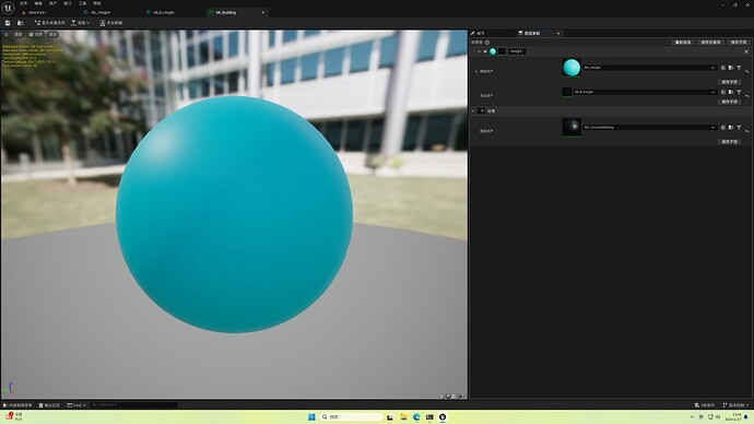

In your third screenshot, you have labeled your material layer as “Height”. Instead, it should be labeled “FeaturesMetadata”.
Let us know if that helps.
Hi @janine
It works! Never thought it was the key~
Thanks a lot!
