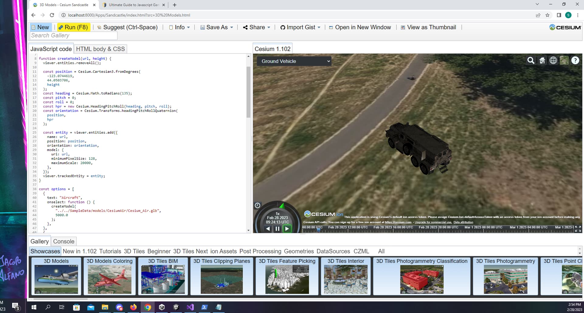

I want to know one thing. Kindly help me. The unity map from cesium has a mesh collider so the object(or player is easily stand on ground). Like shown in image_1.
I want to know. will it be similar in Cesium Js. Like ,Can an object stand on the ground? I will use threejs here for game development in javascript. In image_2 a truck is standing on the ground. I want my 3D character there and it can walk on ground.
Hi @ShubhamSarraf, you would probably do better asking this question on the CesiumJS forum:
CesiumJS doesn’t have any built-in support for collision. But it does have the ability to find the intersection of a ray with terrain, and that may be sufficient for some use-cases.
I haven’t used it myself, but you could also experiment with 3D Tiles support in three.js:
