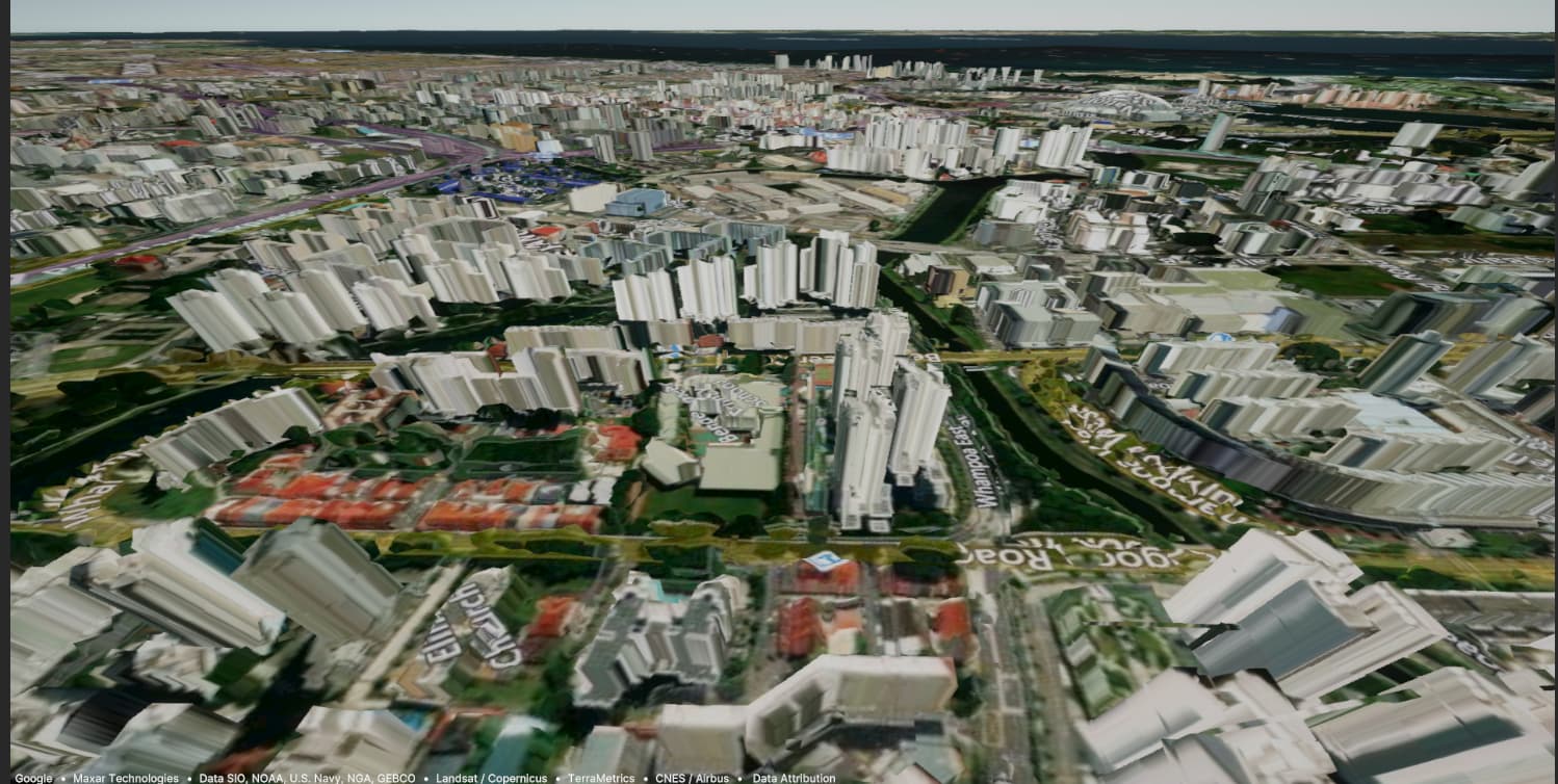

I want show Aerial with Labels in 07_CesiumGoogleMapsTiles.unity demo.thanks!
I don’t think Google (yet?) provides textures with labels baked into them. You could overlay the Bing Aerial with Labels tileset on the Google geometry, but you’ll definitely get smeaing on the sides of vertical surfaces, like buildings. If you want to try it, copy the Cesium ion Raster Overlay from the Cesium World Terrain game object in level 1 to the Google tileset game object in level 7.

I’m suggesting you use the Unity Editor UI to copy a component (the Cesium ion Raster Overlay component that is attached to Cesium World Terrain in level 1) from to the Google tileset in level 7. No need to edit any code.
Or if it’s easier, add a Cesium ion Raster Overlay component to the Google tileset manually and set the asset ID to 3.

Follow your first and second methods buildings definitely get smeaing on the sides of vertical surfaces.
