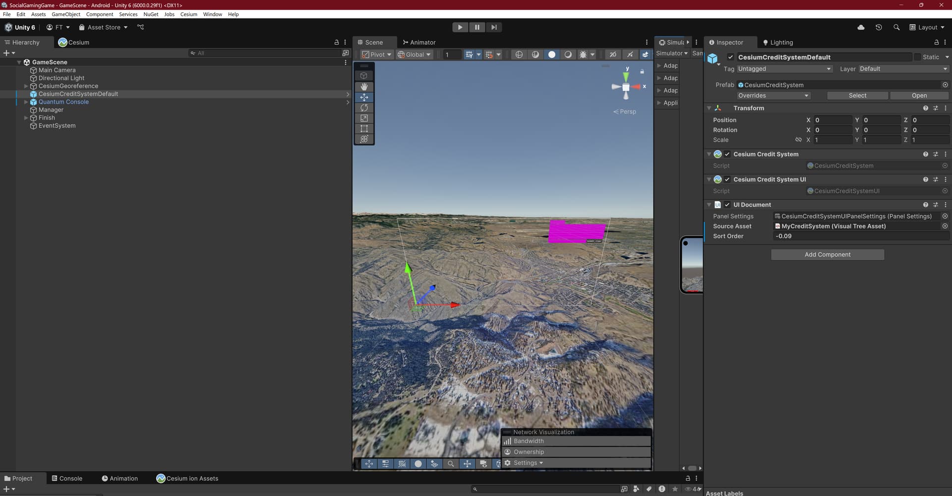

I have tried working on it again. Using the described way I have generated my own uxml file and switched some stuff. However all my changes can only be seen in the editor and nothing gets used during Runtime… Here is my uxml code:
<ui:UXML xmlns:ui=“UnityEngine.UIElements” xmlns:uie=“UnityEditor.UIElements” xsi=“http://www.w3.org/2001/XMLSchema-instance” engine=“UnityEngine.UIElements” editor=“UnityEditor.UIElements” noNamespaceSchemaLocation=“../../../../UIElementsSchema/UIElements.xsd” editor-extension-mode=“False”>
<ui:VisualElement name=“PopupCredits” class=“onscreen-credits-scaled” style=“width: 5px; height: 5px; padding-left: 15px; padding-right: 15px; padding-top: 15px; padding-bottom: 15px; left: 29%; top: 6%; border-top-left-radius: 25px; border-bottom-left-radius: 25px; border-top-right-radius: 25px; border-bottom-right-radius: 25px; background-color: rgba(0, 0, 0, 0.78); flex-direction: column; justify-content: flex-start; align-items: flex-start; flex-wrap: wrap; font-size: 11px; color: rgb(255, 0, 0); display: none; visibility: visible; flex-shrink: 0; -unity-font: none;” />
<ui:VisualElement name=“OnScreenCredits” class=“onscreen-credits-scaled” style=“width: 5px; height: 5px; position: absolute; bottom: 0; flex-shrink: 0; flex-direction: row; align-items: center; width: auto; padding-left: 5px; padding-right: 5px; padding-top: 5px; padding-bottom: 5px; flex-wrap: wrap; font-size: 5px; color: rgb(19, 0, 255); -unity-font: none; align-self: flex-end; -unity-text-align: lower-left; height: auto; text-overflow: ellipsis;” />
</ui:UXML>
and here is the used uss code:

this changes everything in the editor
but during runtime everything reverts to this

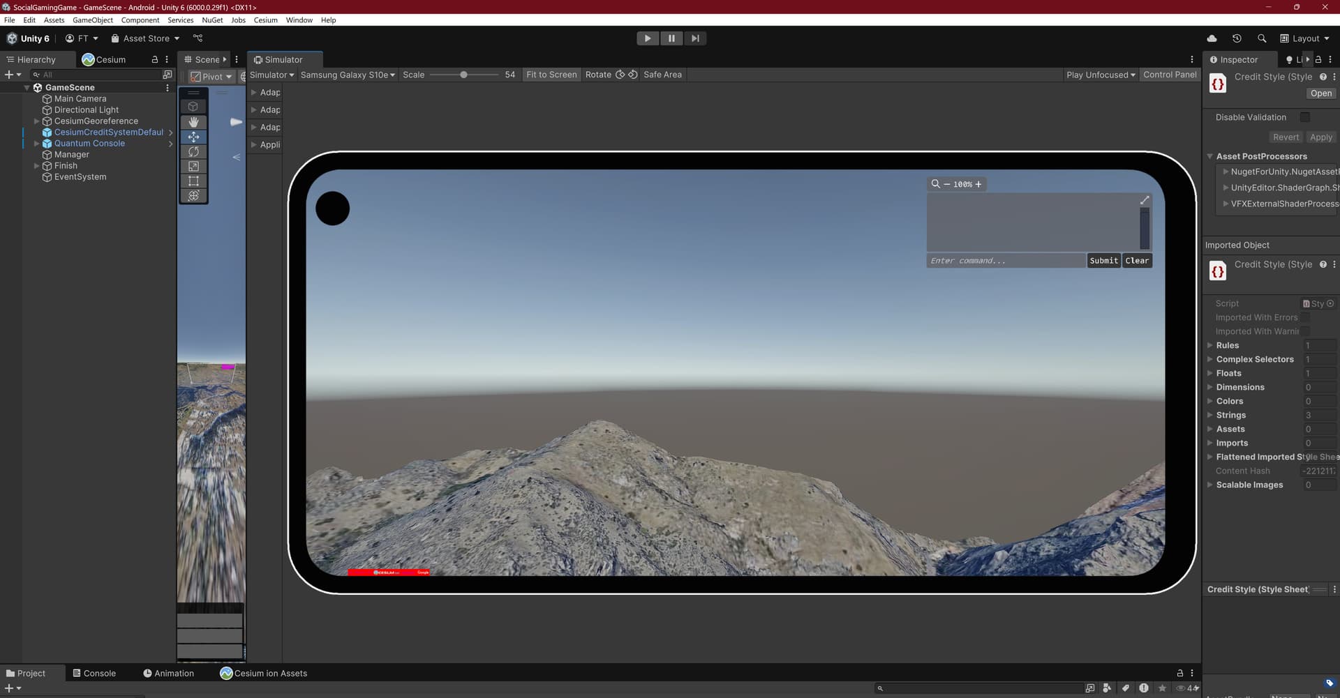

as you can see here, i made my own new credit system
I’m looking forward to your help
update: suddenly it works??? now the credit system position suddenly changes depending on where I look… I’m so confused
ok… when i add the position fixed to the css file i now works
