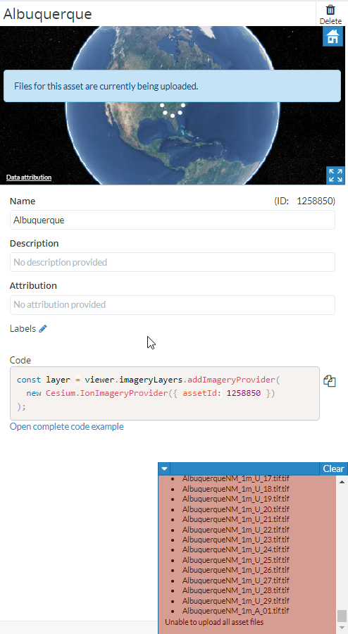

Yes, I’m seeing an error when I upload them all as one asset. It says “Unable to upload all asset files”. Without a more specific message, I have to assume the number or the total size of the files is too big. I’ll try both of your options unless you can tell me what this message indicates.

Yes, I’m positive. Cesium Ion says “12.13 GB of 50.00 GB used” and I can’t even upload a group of files that are 2.26 GB in total. I still get this nondescript error saying “Unable to upload all asset files”.
