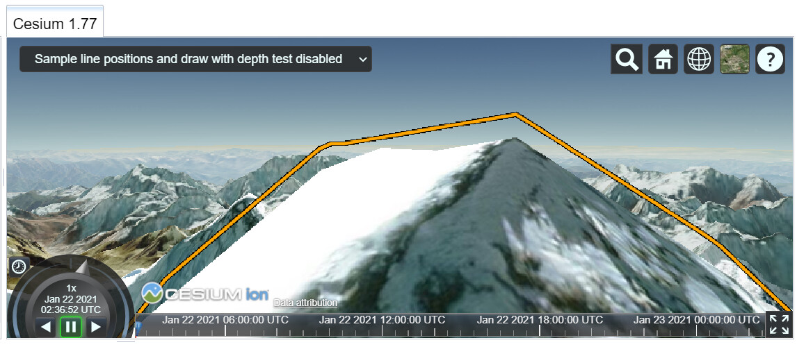

Hello,
I ran into a problem similar to yours recently. And I found sampleTerrain() function very useful.
There is also a Sandcastle Demo shows the output feature like this. (Cesium Sandcastle to Terrain.html)
The polyline looks “clamped to the mountain” with each point 10 meters offset upon the mountain surface.
Hope it Helps.
Best,
Yujie
