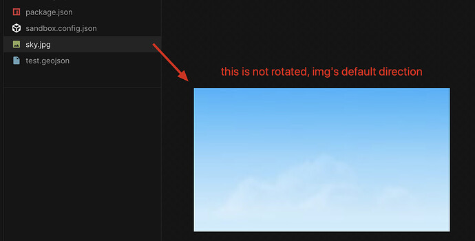

polyon setting ImageMaterialProperty material, but img init rotated
demo:https://codesandbox.io/s/romantic-shockley-39dyp?file=/index.html
this is my demo.
when load test.geojson ,img is rotated
when load normal.geojson, img is normal
i want img is normal, not rotate.
How can you tell if the image is rotated or not?
Cheers,
Alex
sky.jpg default direction is normal
loaded geojson , set material , but rotated -90deg

Hmm, a bit out of my league, but maybe try to use MaterialAppearance - Cesium Documentation with the faceForward = true. I think the material engine does some automatic rotation for the benefit of a better render of textures. Give it a spin.

Hello @chaijinsong,
When Cesium renders a polygon, it doesn’t have a reference for which direction that polygon is oriented in space, so we do our best guess for how to fit an image onto that polygon.
In order to achieve the effect you’re going for, I think a Wall would be a better fit: Cesium Sandcastle
This should render the texture in the correct direction.
