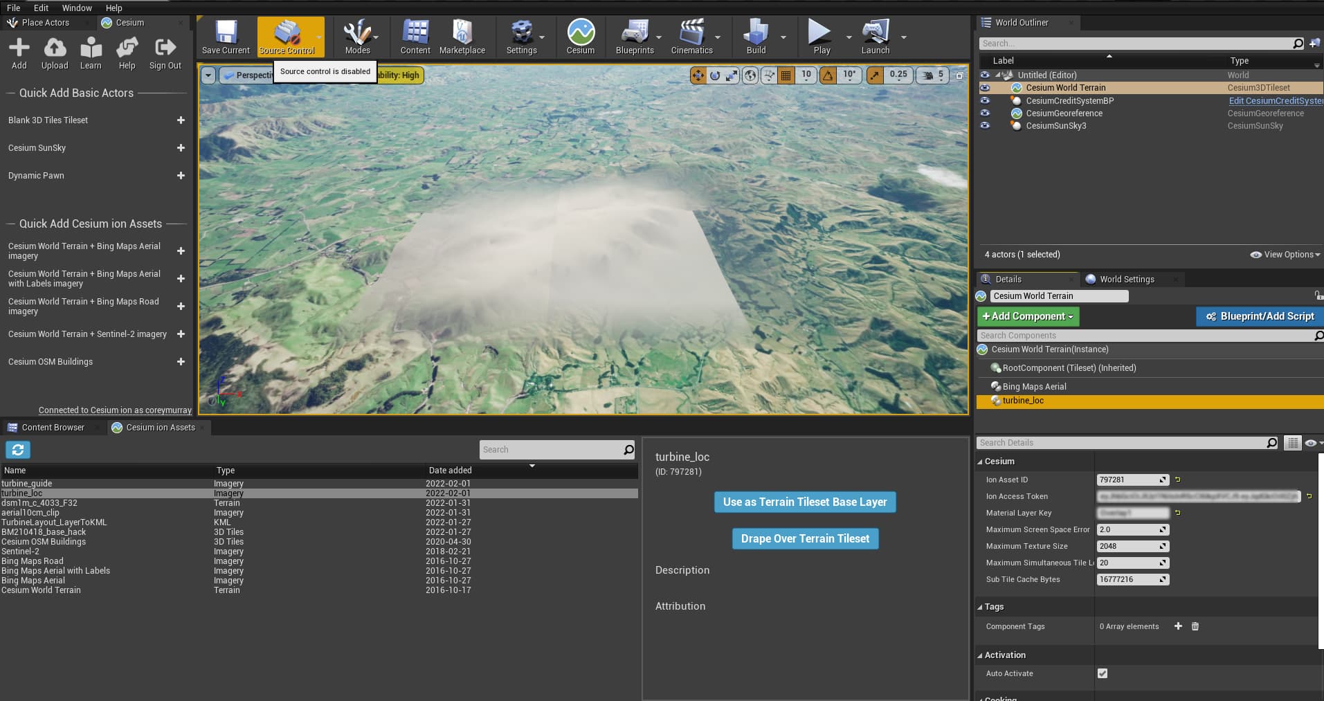

I have set up a raster imagery asset (geotiff map) in Cesium Ion, preview looks fine. In UE4, I can find and add to the level, but it only displays as a set of grey pixels as per image below. Any help would be greatly appreciated.

Hi @coreymurray,
I’m not sure offhand what would cause that, but we will investigate. May I have your permission to access your Cesium ion asset to debug? If you can also (privately) send me an ion access key that grants access to that asset, that would be very helpful.

Hi,I met the same situation,Could you share the solutions please? I appreciate you greatly
Hi,
The original problem mentioned here was caused by an old version of Cesium for Unreal. After updating to the latest version, the problem went away.
