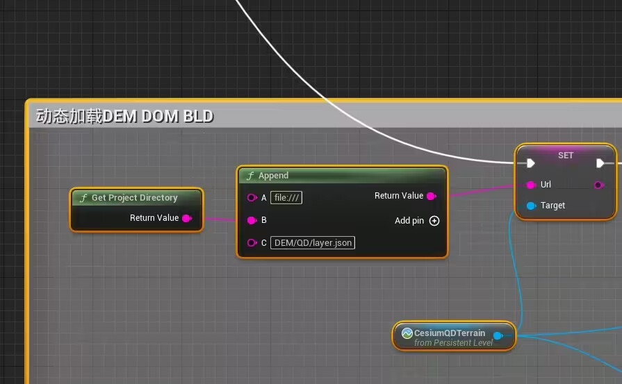

Taking terrain data as an example, here is the way of loading local data of tileset using relative paths.
  1. Handling of local terrain data during development
(1) During the development process, put the terrain data in the directory shown below, noting that the directory of the .uproject file is the Project Directory .
(2) In the Editor of the project, absolute path of loading data can be used, which is only for reference and debugging during development.
(3) Set the url of terrain during runtime using relative paths,i.e Project Directory , so that the program can run on any other computer only if the package(including the terrain data) is copied.
Here is the Level Blueprint, EventBeginPlay to execute the following blueprint.

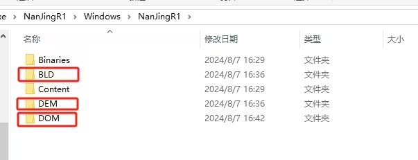

  1. Processing of local terrain data after packaging
After packaging , the folder of the same name with the project and at the same directory as the .exe file is the Project Directory. You will need to manually copy the terrain data into it. The directory of this project is as follows:

Hi @Nick2,
To check your results, add a Print String node with the result of the Append before you set it as the tileset URL, and verify that it matches a) what you expect, and b) the actual path on the file system.
Hi, Nick2,
It is hard for me to tell what’s wrong according to the screen shots. The Blueprint seems right. Kevin’s advice is very useful. Try the print string node.
I will briefly reiterate the key points again, so that you may review them once more and find something.
  1. During the development process. the directory of the .uproject file is the Project Directory .
  2. After packaging , Inside the folder of the same name with the project is the Project Directory
  3. Additionally, it is important to note that when copying a package, the absolute path of the entire folder should not contain non-ASCII characters or strange symbols, and ideally, there should be no spaces either.
